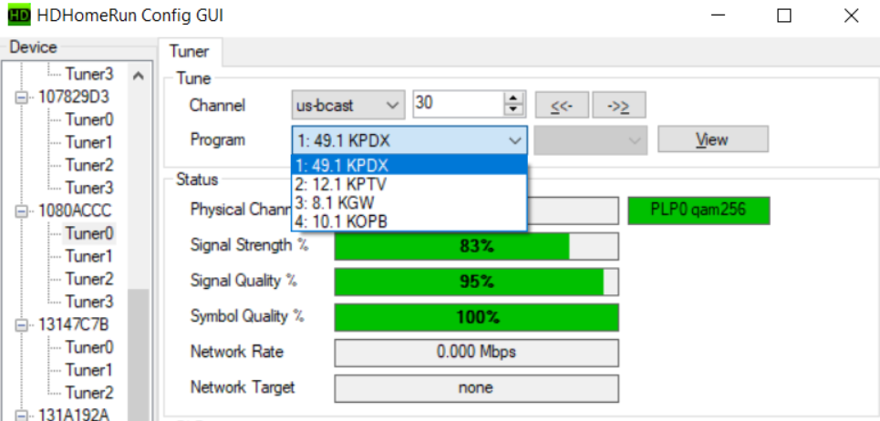

This information is actually stored in the tuner. Current ATSC1 models cannot specify/filter PIDs when accessed via HTTP.
However, the ATSC3 tuners do support specifying multiple PLPs in the URI when tuning over HTTP. However, I don't believe it supports modifying it on the fly the way can change the PID filter over their "legacy" UDP C API. For information, here's the forum post on accessing the ATSC3 http video stream.
