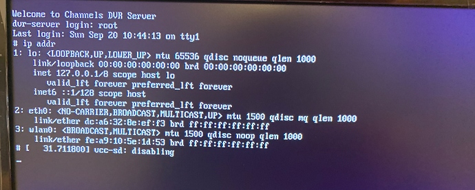

Type ip addr after logging in with root

Amen (@tmm1) the back of the Ethernet port is not lit up at all!
Below a screenshot of what the results were when I typed ip addr...
Awaiting further instructions....
You need Ethernet link. Maybe it's a bad cable or something. Do whatever you need to in order to make the light on the back turn green.
