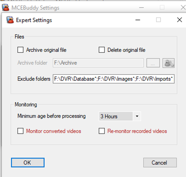

Monitor Location Expert Settings
My set values are for Excluded folders and minimum age.
Exclude folders accepts a semi-colon separated list of folders. Notice in my list, I add an asterisk (*) to the end of the folders. The asterisk is a wildcard that excludes subfolders. So, “F:\DVR\Database*” indicates to exclude the DVR Database folder as well as any subfolders under it. Since I chose to monitor the root directory for my DVR, I exclude all nonrelevant subfolders such as Databases, Streaming, Images, etc.
Minimum age before processing inserts a delay before a found file is processed. I set this to 3 hours to allow ComSkip processing time and to keep the server activity lower during prime time, when several recordings may be happening at once.

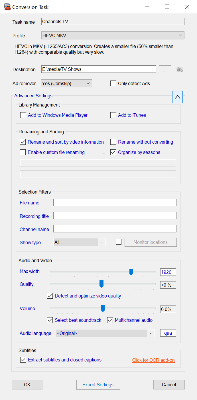

Long time Plex/MCEbuddy user, first time Channels DVR user, trying to figure out a workflow. Mine is a little bit different. I use MCEBuddy to rename and move the file into my main TV show library (it also compresses and comskips). Then Channels reads it back as imported local content.
There are two problems with this approach I need to figure out. #1 it creates duplicate listings with one being missing, since the file is deleted outside of Channels. Are those missing files/entries auto-purged in maintenance? I know how to do it manually. #2 is the hanging JSON file. Although it looks like Plex will index the episode correctly without, MCEBuddy doesn't clean up the file name.
