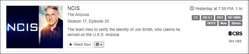

My recording of NCIS failed
My recording of NCIS failed. Is there a way to find out why?
I clicked on View Recording Log and it said:
loc=188 pkt=2 pid=480 what="pat_and_pmt" offset=0 length=376 contiguous=true changed=true packets=2
The file it produced was only 46.6 MB instead of 3.5 GB. VLC won't even play the fragment.
