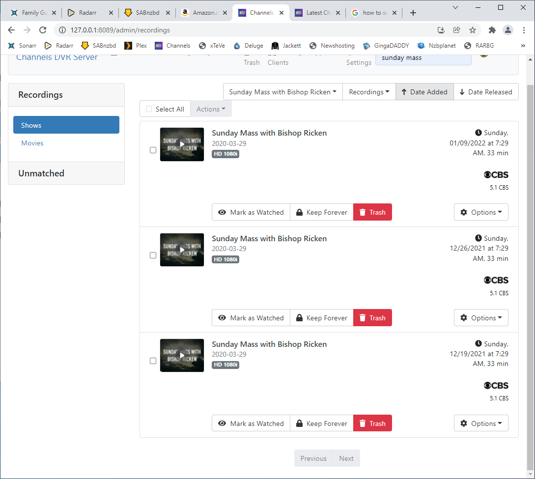

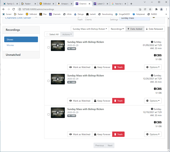

I have a local broadcast that I record every week. The show does get properly listed at its scheduled time. And will record at its scheduled time. But once its recorded, it will not que up again for the next scheduled airing. Basically it is Sunday mass, but it is always dated 2020-03-29. That must be the original first broadcast date. Anyway, I have made a pass, but once it has been recorded, Channels always thinks its the same show already recorded and I have to manually que it up to record the next airing. So I basically would like Channels to recognize its a different show, or at least give an option to always record. And no, selecting ALL episodes in the pass does not work.
Currently I have these files:
TV\Sunday Mass with Bishop Ricken\Sunday Mass with Bishop Ricken 2020-03-29 2021-12-19-0729.mpg
TV\Sunday Mass with Bishop Ricken\Sunday Mass with Bishop Ricken 2020-03-29 2021-12-26-0729.mpg
TV\Sunday Mass with Bishop Ricken\Sunday Mass with Bishop Ricken 2020-03-29 2022-01-09-0729.mpg
