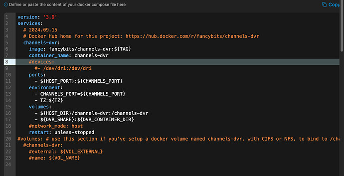

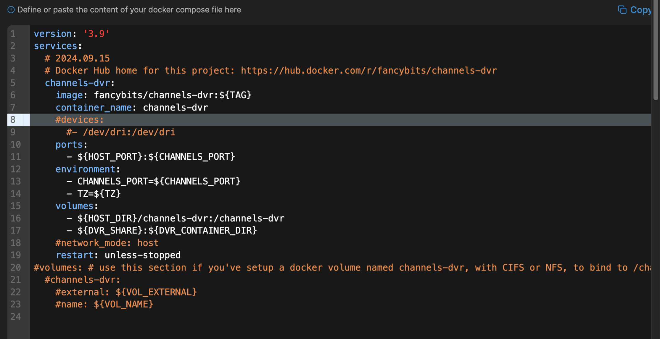

I think this is what you're looking for:
That's the compose part, but please add the Environment section which contains most of your installation specific values.
Also, please put 3 backticks before and after sections of code, logs, variables and the like to make them more readable. You can edit your post to fix the above.

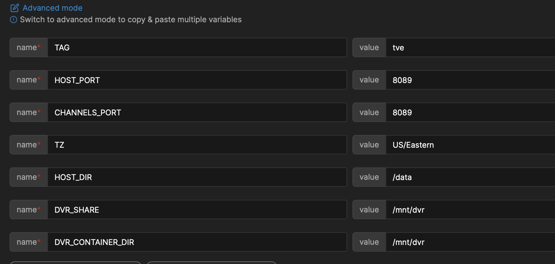

I'm guessing that /mnt/dvr is not where your Channels recordings are stored? The value DVR_SHARE is where you define the location in your Unraid filesystem, and DVR_CONTAINER_DIR defines what the directory will be called inside the container (in this case you can name them the same for convenience).
I changed the compose post to a screenshot.

/mnt/dvr was pre-filled out in the DVR share section when I was installing channels. I changed it to match in the DVR_CONTAINER_DIR field. It is also the only way I could get Channels to see the streamlink files created by that add-on.

There are several ways we could approach this, but I think if you changed the value of DVR_SHARE to /mnt/user and DVR_CONTAINER_DIR to the same, we could cover all the bases. That way everything in /mnt/user will be visible to you inside the container.
Create a directory under /mnt/user called channels_data or dvr, and set that in the CDVR WebUI as the location for your Channels data. And then, import your personal media as /mnt/user/movies and /mnt/user/tv_shows. How's that sound?
Holy smokes! That simplified everything! Thank you so much! I can now navigate to all of my media folders from the channels interface and the streamlinks are working!
