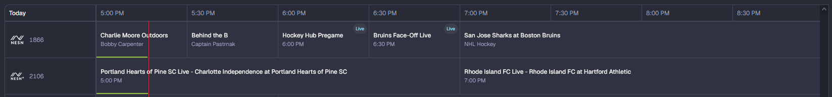

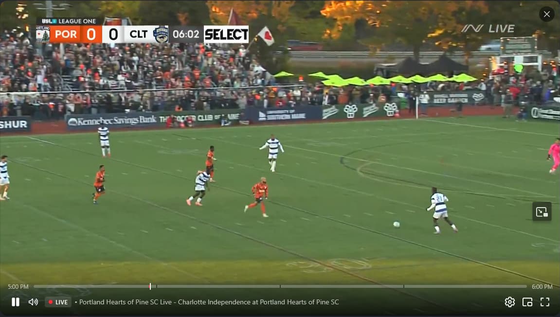

I just want to point out that as of v5.7.0 of FastChannels, you can now get NESN and NESN+ easy peasy!
You do have to use a capture method of some kind (direct HDMI capture, ah4c, ADBTuner with Passthrough stations, PrismCast), but it has been working seamlessly during my testing.
It's basically maintenance free once you get it going, so I definitely recommend going down this path if you're looking for a way to finally have NESN and NESN+ working again in Channels!
