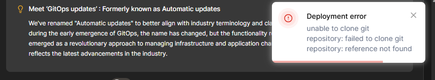

I'm trying to install DeepFruitLinks via your Portainer instructions.
I followed your steps you outlined, but when I try to deploy the stack, I get this error:
I'm trying to use this Repository URL.
tell me exactly what you entered for Repository URL and Repository reference, I can point to the exact fix.
