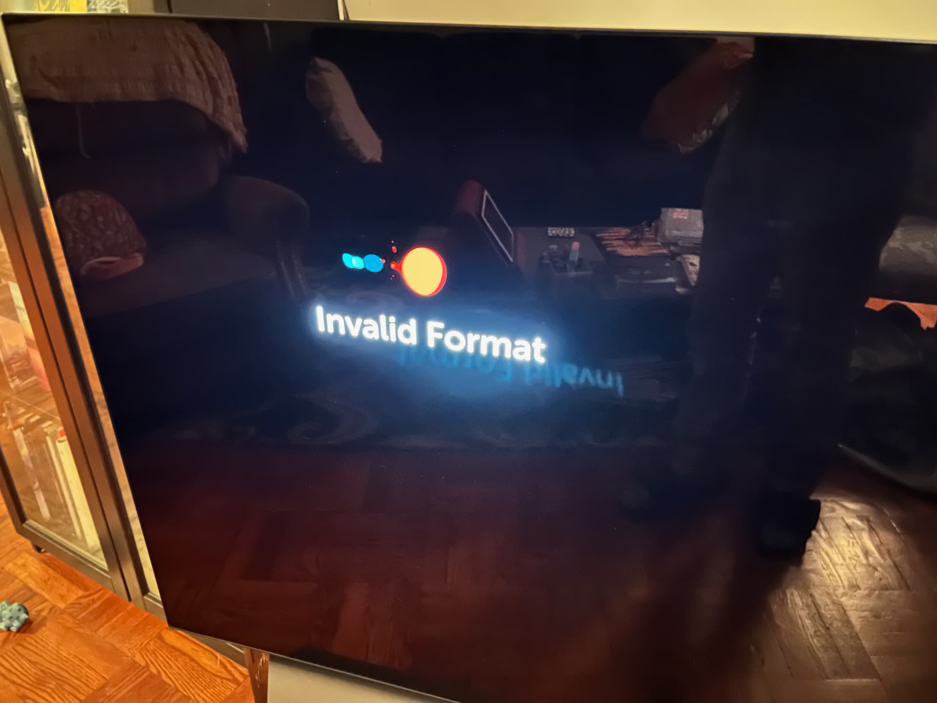

Okay, so I'm seeing an "Invalid Format" graphic.
Weird I hven't seen that before. Wht happens if you plug in hdmi before powering the pi
That is what I did to get this result.
Isn't that the tv/monitor message meaning the input format (resolution) is not supported on your tv. The Pi does not display that kinda graphic. Try using a normal HDMI computer monitor or a different tv.
Might also be a bad cable.
