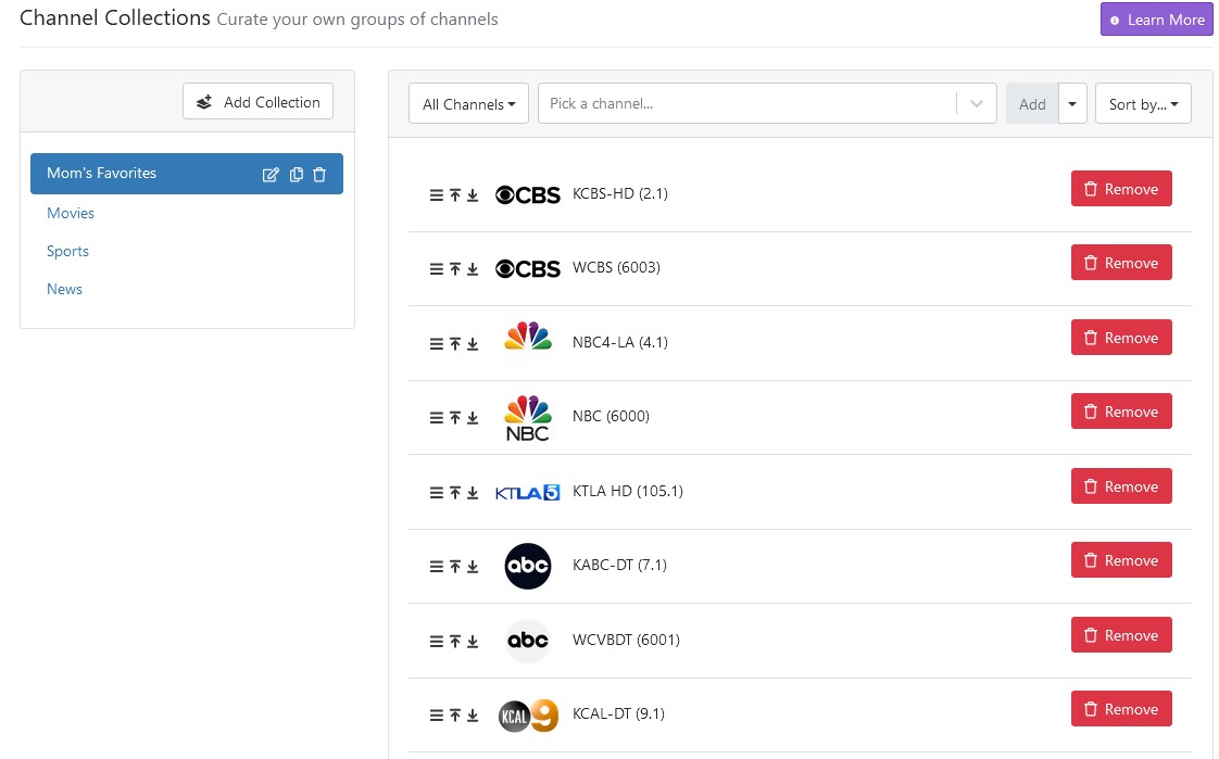

I have a collection that is missing a channel in the admin web Grid Guide filtered view. I've tried removing the missing channel and adding it back in but it still is missing. CH 6000

@maddox, I’ve noticed a possibly related bug with channel collections on the web EPG: if you have multiple sources and any channel in your collection has a channel number that conflicts with a channel number from an HDHR source, those channels will be missing in the web EPG.
I have an HDHR on my network that shows up in Channels as a source but is not configured (I instead access it through an M3U so I can set more logical channel numbers). Even though the HDHR isn’t set up, its channel numbers still seem to have influence in Channels. For example, in my M3U channel 32 is ITV2; on my HDHR channel 32 is 5STAR. I’ve added channel 32 to my ‘General’ channel collection, but it’s missing in the web EPG. It appears as expected (as ITV2) on clients.
The same issue happens with Pluto channels if you added the M3U and selected ‘prefer channel numbers in M3U’. If any of the Pluto channel numbers conflict with the unconfigured HDHR, they will disappear in channel collections on the web EPG.
