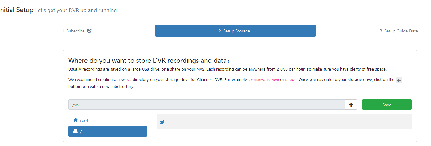

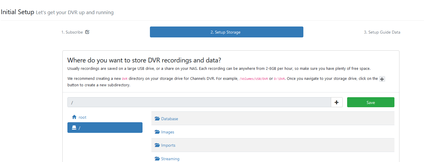

Got the new docker container deployed, but when I go in to start setting up the server @ http://9.9.9.90:8089/admin/settings, I get to the point of setting the storage location (which already exists from a previous install), I can only pick one top level directory:
I thought this would already be set up in my "Volumes" section of the container?
I could brows to the location where I have my old recording set, but I can only pick the top level directory.
I also noticed that in the instructions on Dockerhub, when you deploy, it creates a new volume called 'channels-dvr' in the top level directory tree. Do I pick this?

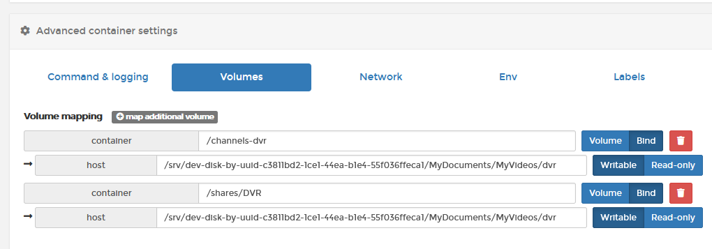

Yes, I did bring the proper volume mapping.
Here's my volume config:
Does this look correct?
If so, then how should this screen look?:
Should it mimic the /mnt/disk/dvr/recordings (but with the /src/dev-disk-by-uuid....) setting?
Your "config" should be mapping to /channels-dvr. As for your recordings, if that is indeed where you're mapping them into on the container, then you shouldn't be looking in /srv, but rather /mnt/disk/dvr/recordings.

If I'm setting the directory where my recordings are when I set up my container, why am I getting prompted to set it up again when I log into channels-dvr via a web browser?
Shouldn't the container already know where I want my recordings kept?

There's two directories:
/srv/dev-disk-by-uuid-c3811bd2-1ce1-44ea-b1e4-55f036ffeca1/MyDocuments/MyVideos/dvr - the config?
/srv/dev-disk-by-uuid-c3811bd2-1ce1-44ea-b1e4-55f036ffeca1/MyDocuments/MyVideos/dvr/TV - the recordings
I set these up in the docker config.
When I log into my newly created channels-dvr server, I get asked to pick a storage location. It does not let you pick a directory more than one level deep. And why do I need to set this again if I've already set it via the docker setup?

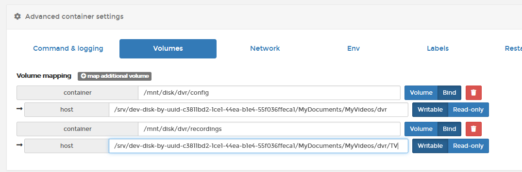

This is what the 'config' directory should look like for my installation correct?
And the recordings are here:
Those should be all I need right?

  --volume /mnt/disk/dvr/config:/channels-dvr \
  --volume /mnt/disk/dvr/recordings:/shares/DVR \
The container paths should be /channels-dvr and /shares/DVR. That doesn't match what you're using.
(first time docker user, sorry for the dumb questions)
I super appreciate the help guys!
Should it be like this? Or does the /shares/DVR path need to end at TV?
No. The config directory is completely separate from where your recordings are stored. It's where the software itself is installed.
The /shares/DVR is correct. The other one should be pointing somewhere else at a blank folder where the software can be setup.

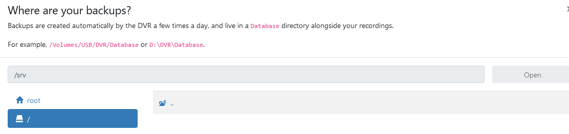

Dang. I've tried this in Chrome and Firefox and it's the same on both.
If I go to the restore link, and try to search for the directory path, the box is grayed out.
It will only pick the top level directory that you select.
I need the path to go to:
But it will only select the /srv directory.
Any way to get around this?
Everything is grayed out. I would happily copy/paste my path into the box, but it's grayed out.
That's the path on the host not the container
I just mean for the backup location.
I cannot browse to the backup location that is on the host. the browser lets you pick one directory but not walk the directory to the correct location. I've tried on both Chrome and Firefox.

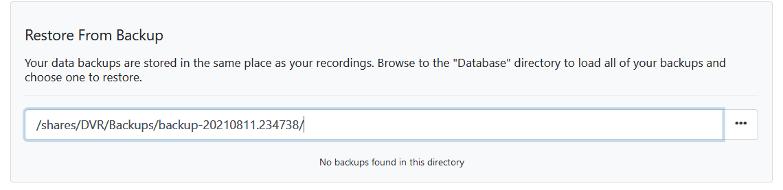

Was finally able to paste in a path.
The backups are definitely in this directory, but:
That's still not the correct location. That's the path on your host. The container cannot see paths in your host.
What is your volume mapping now? Whatever you mapped your dvr folder as is where the backups will appear on the container.
