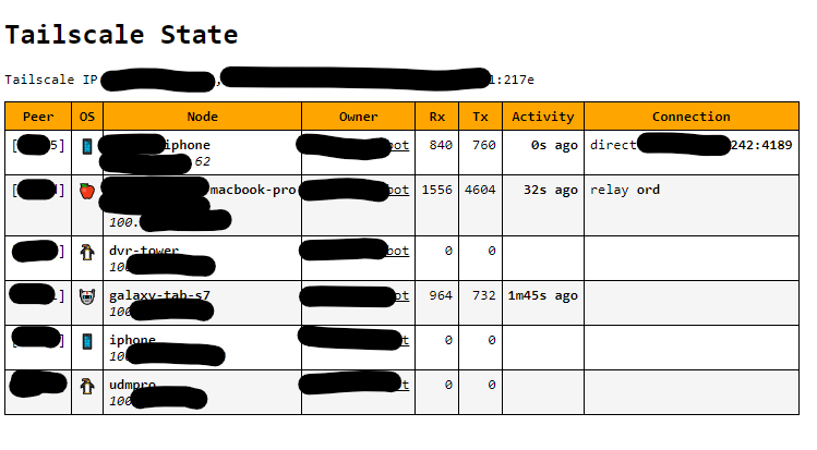

One useful feature within Tailscale is to determine if you're directly connected to the server or going over a DERP relay. There's a command you can run from your Tailscale server to enable a simple web page that shows the connectivity status for all your peers. It would be nice to expose this on the Channels server web UI.
On my Unraid server I enable this feature by running the following from the docker console for the instance:
/app # ./tailscale status --web --listen 0.0.0.0:8384
Serving Tailscale status at http://192.168.1.106:8384/
You then open a web page to the IP with port 8384 and should see something like the following:
Mind the paranoia with the blacked out info. You'll see that clients that are connected will show the direct IP address or a relay in the connection column (e.g. relay via ORD - Chicago).

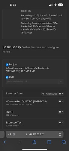

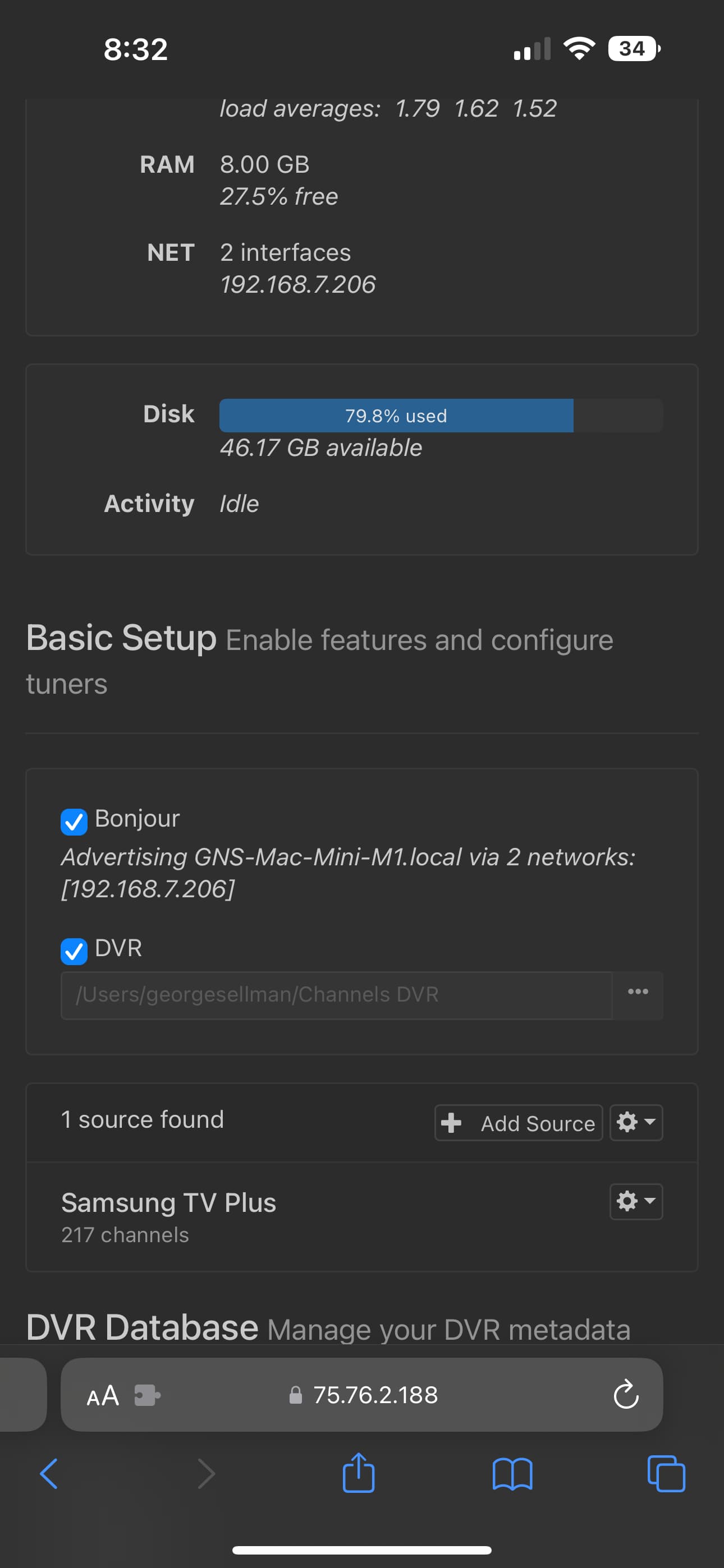

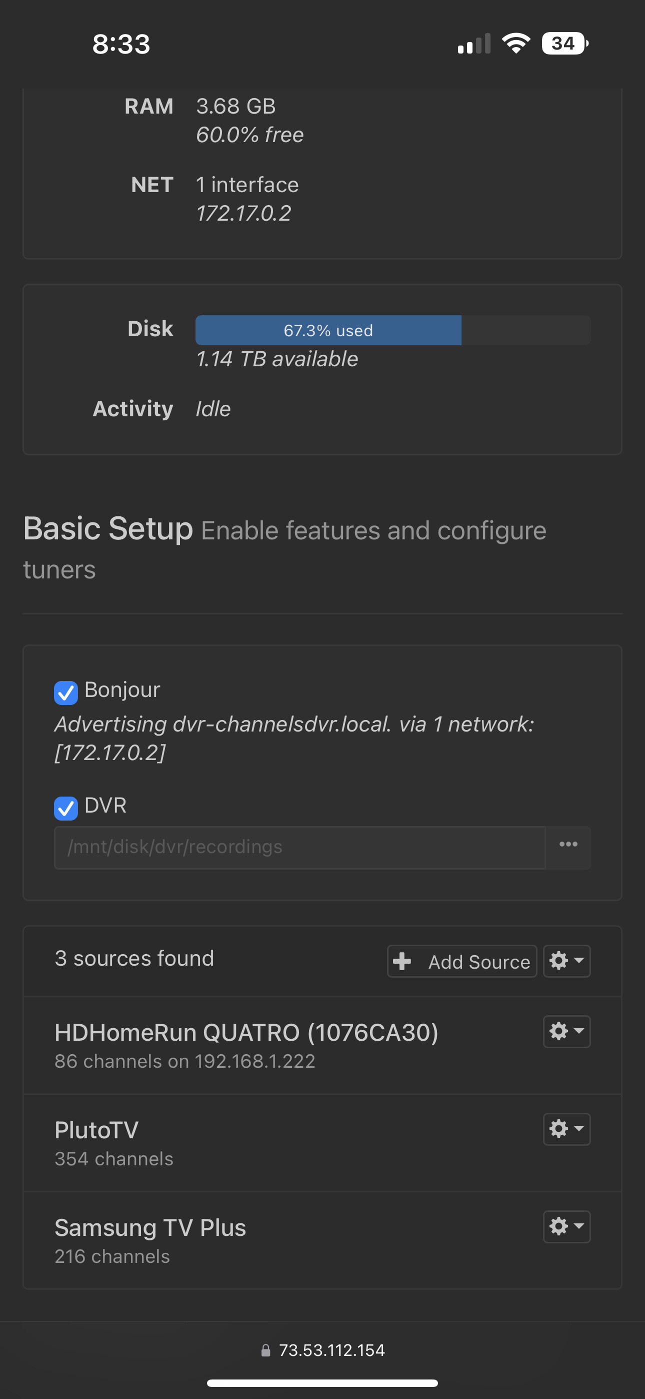

I didn't have a proxy server in front of the DVR, just a port forward from my firewall to the Channels DVR server, since they can't get in without authenticating. That doesn't protect you from them capturing the initial HTTPS connection request and SSL certificate. This signals the Shodan port scanner that a service is running on that port and they catalog your IP address on their website.
You can find examples right here of servers running Channels DVR: https://www.shodan.io/search?query=channels+dvr
I'm a little surprised no one else is familiar with this service and the need to protect to your external facing servers: What Is Shodan? How to Use It & How to Stay Protected [2022]
