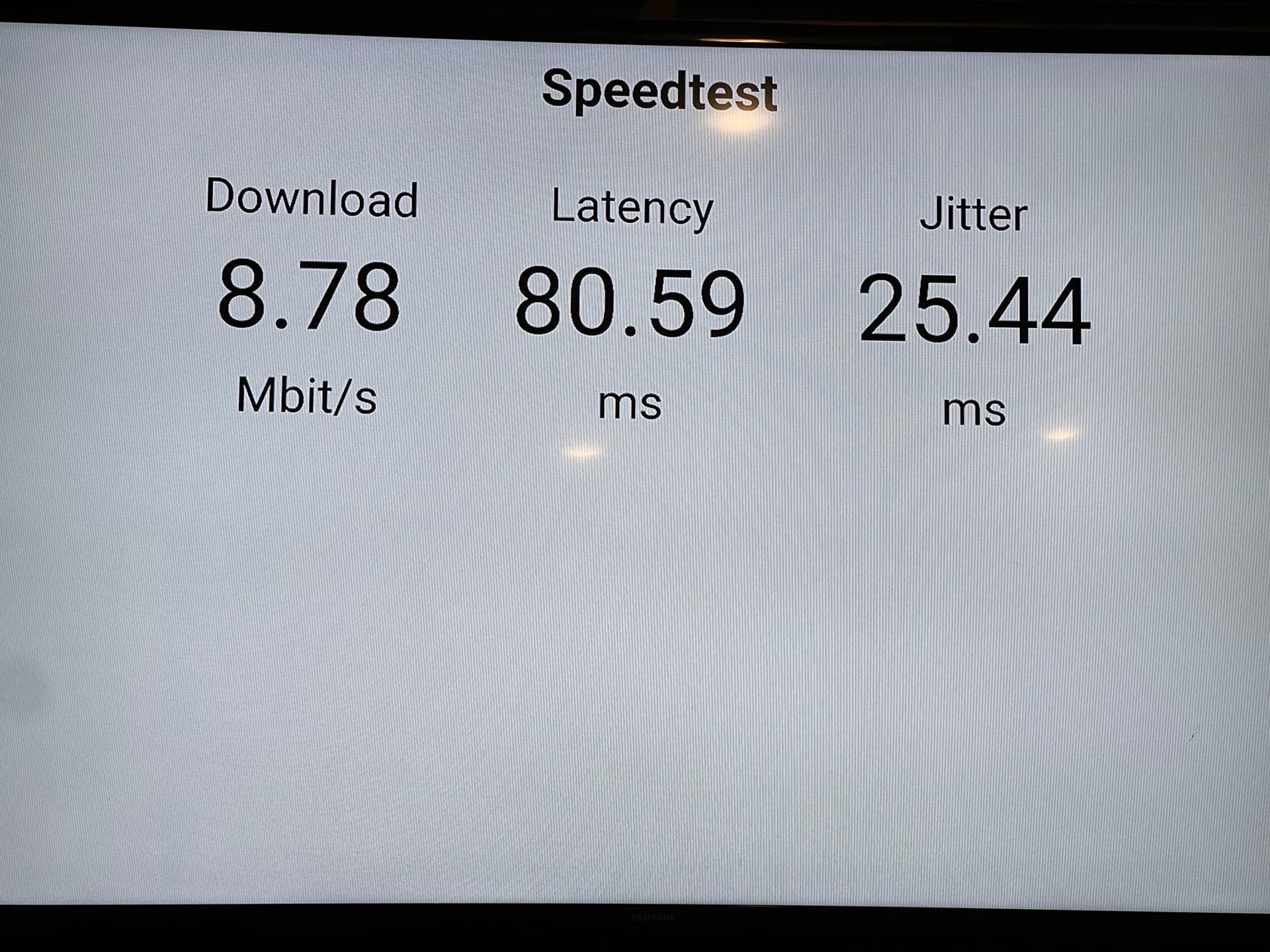

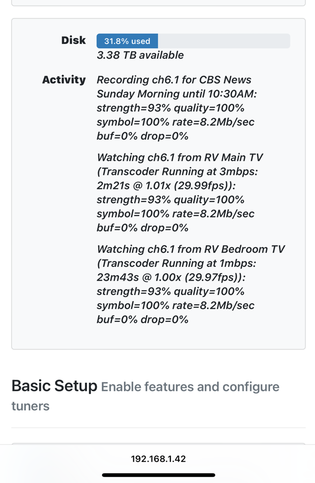

I have been using Tailscale with my Qnap Server and Tivo Stream 4K for quite a while. I have traveled to Prince Edward Island in Canada and Nova Scotia using Starlink and LTE via a ConnectT 2.0 in the states. I also traveled to Iowa using LTE only. I have a cheap Spectrum 300M down 10M up internet at home. I use 3M on my main TV and 2M on my bedroom which always seems to drop to 1M. The Main TV is nearly perfect on HD. The bedroom is very good and I can always move the stream speed up if needed. I have no signal drops and can watch anything. I have seen locations where LTE isn't good. I do not have 5G. But StarLink is always perfect. I would suggest you check your router/modem. FYI, I am not using the developer's integration since I need to reach my server for security cams, WX station and Smartlink hub. Hope you get it going. It is truly a great thing for RV-er's.
Yes I get that same rate around 7-9Mbps on some TailScale clients but other times it is lucky to sustain 2-3 megs. So typically I set a default 1Mbps stream rate on all devices and scale up from there as the connection permits. Honestly on a lot of screens 1Mbps works just fine, I don't need high quality.
