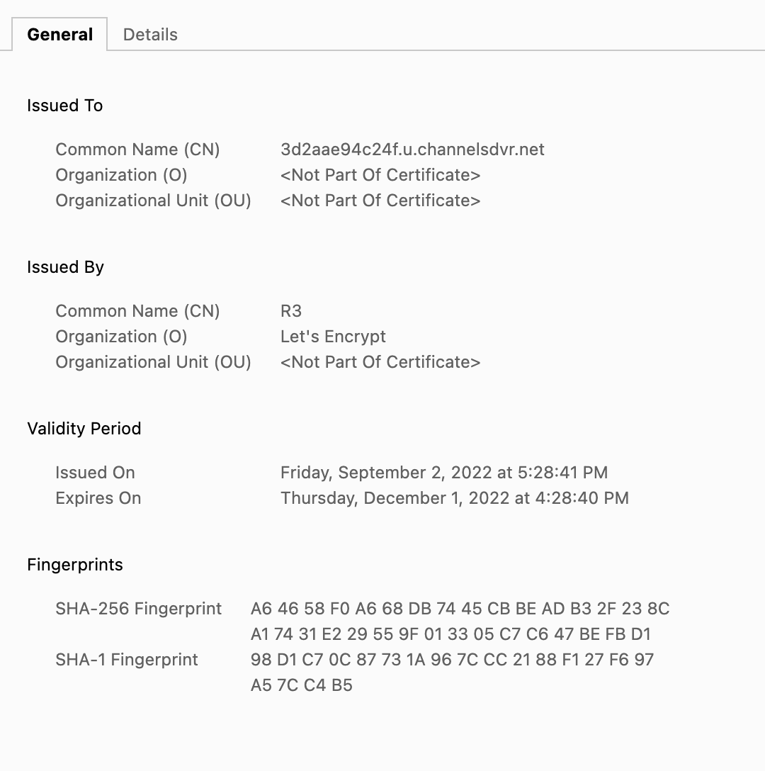

I didn't have a proxy server in front of the DVR, just a port forward from my firewall to the Channels DVR server, since they can't get in without authenticating. That doesn't protect you from them capturing the initial HTTPS connection request and SSL certificate. This signals the Shodan port scanner that a service is running on that port and they catalog your IP address on their website.
You can find examples right here of servers running Channels DVR: https://www.shodan.io/search?query=channels+dvr
I'm a little surprised no one else is familiar with this service and the need to protect to your external facing servers: What Is Shodan? How to Use It & How to Stay Protected [2022]

I never said I could get to my Channels DVR server page without authenticating. I do get the page to authenticate.
What I'm saying is that it exposes the let's encrypt public key which allows Shodan to record the IP address as running a service on that port and gets added to their catalog. Am I making any sense?
The whole point of this topic was my support for Tailscale. No ports are exposed to the outside world which is GOOD.
Got it. Yes, it will expose the CN, but not the X-Channels-DVR-Identifier: header.
