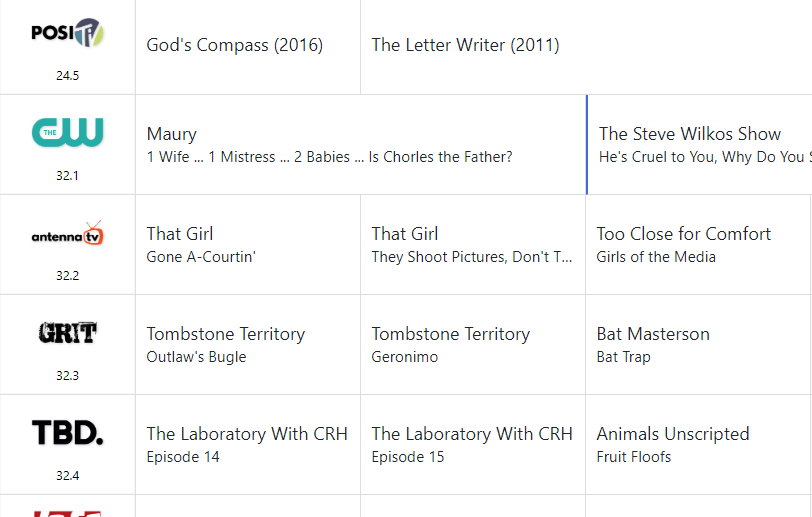

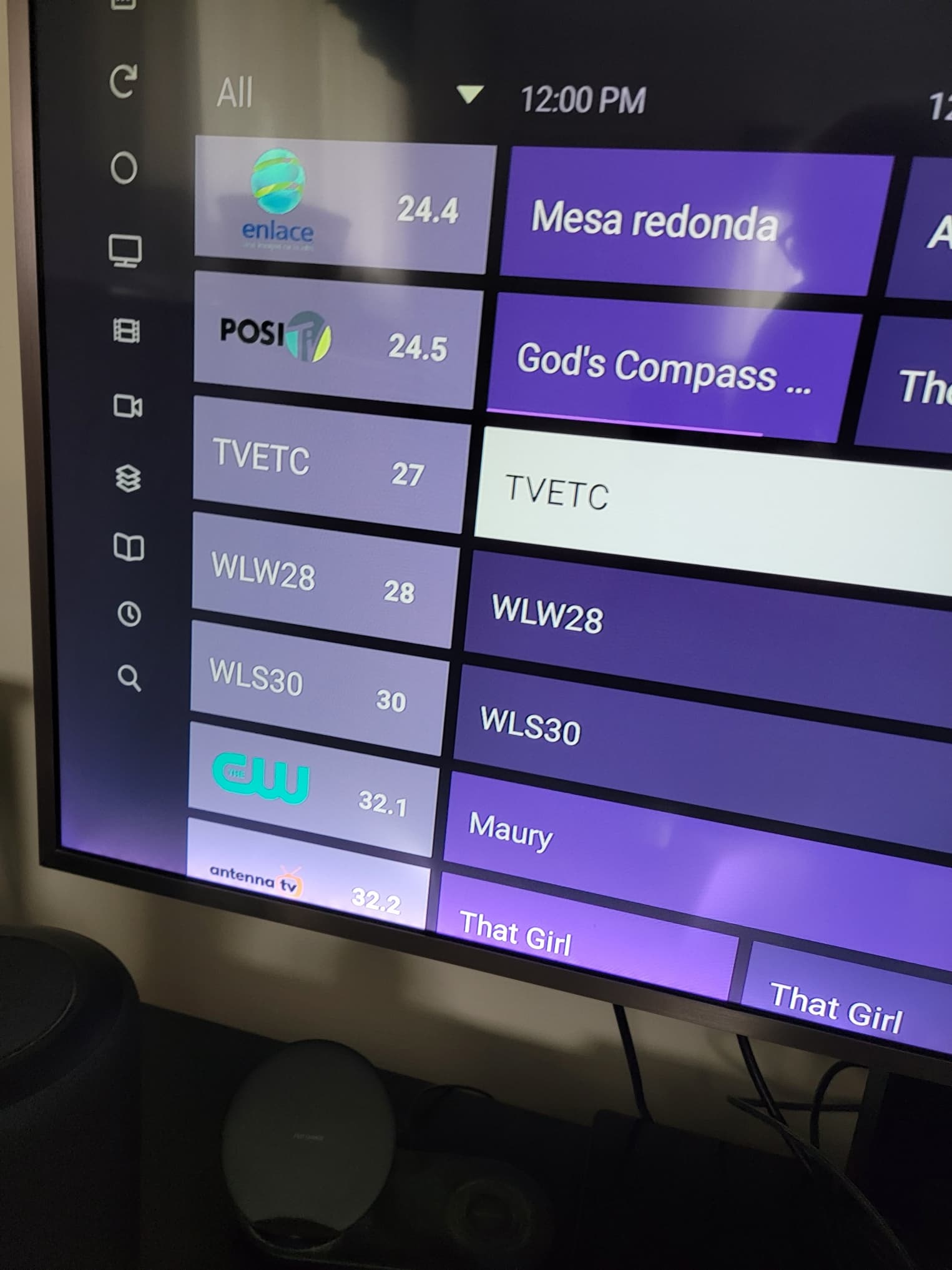

I can keep scanning my unused tuners and channels will pop up randomly in the client guide but not in the source. Here is another good example just did another scan and the clients picked up a few more analog channels...
In my experience they will pop up once and I’ll X them out never to be seen again. Channels remembers even if they are there or not on rescans. I guess it’s different for you
As you can see, they do not appear on the server only the Clients get those fake channels.... The Clients do not require the server to get its channels they connect directly to the tuners so you can watch without tuners sharing.... so during a scan it thinks those channels being scanned are active.

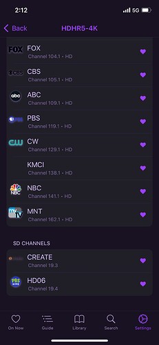

On iOS client X’ed out channels don’t show up. I will have to check my shield tv later to see if they do there
You are talking about something different. I am talking about channels that appear on the clients after a scan even though no tuner has those channels active. I know I can sync the source and they will go away.... but that does not stop others from popping up.... or fix the problem.

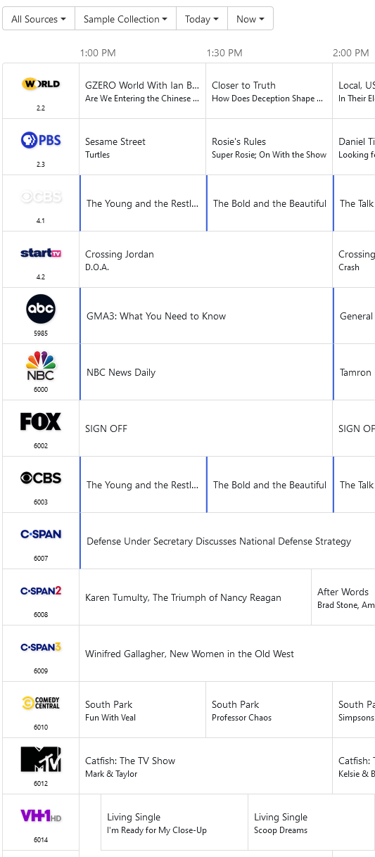

No problem ... What I did is create a Channels Collection with all the channels that way it only adds channels that are added to the server.

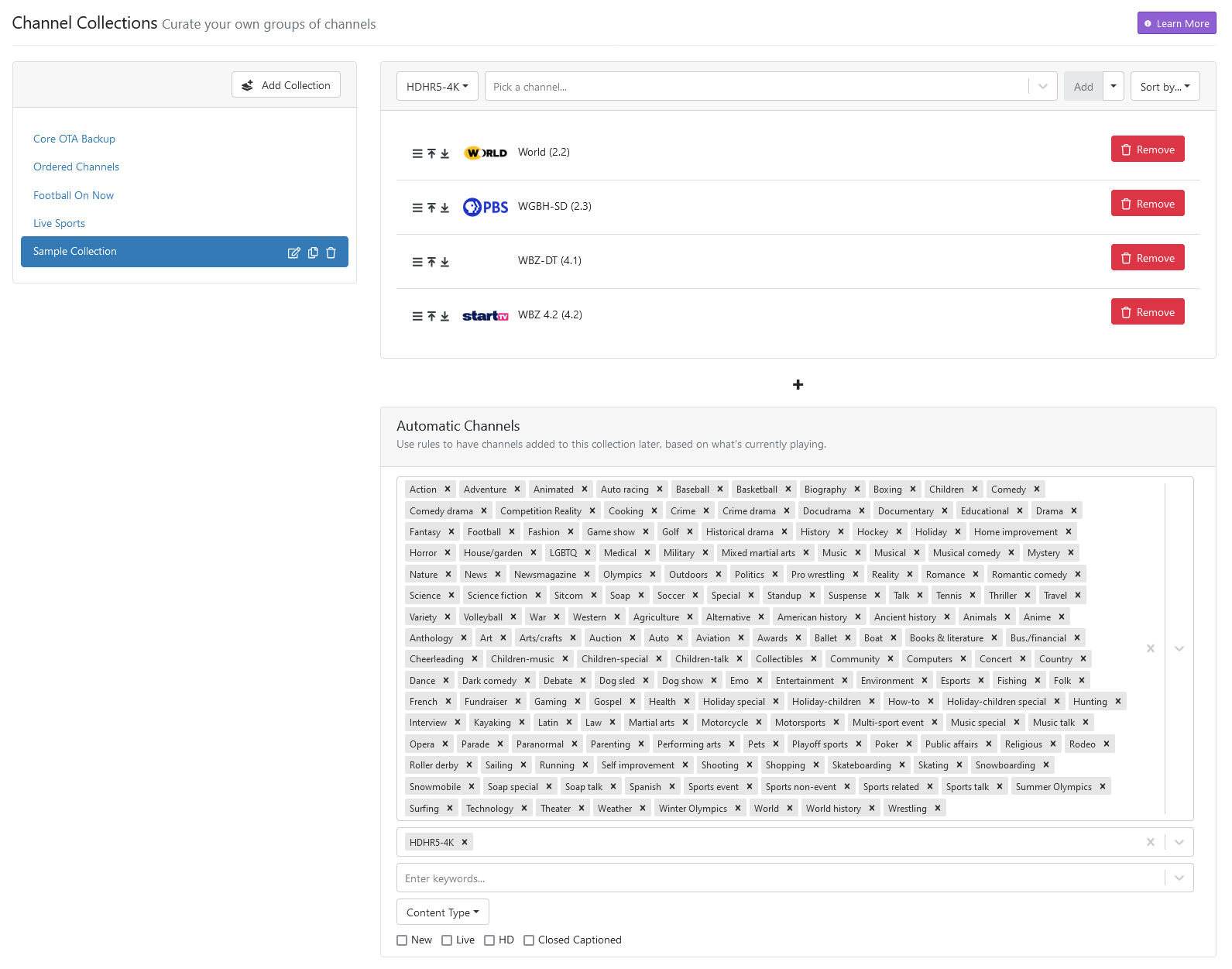

Okay, here you go:
I manually added the OTA channels and then for the automatic I put in every category and excluded the HDHR as a source:
Worked perfectly and took me 5 minutes to set up.
