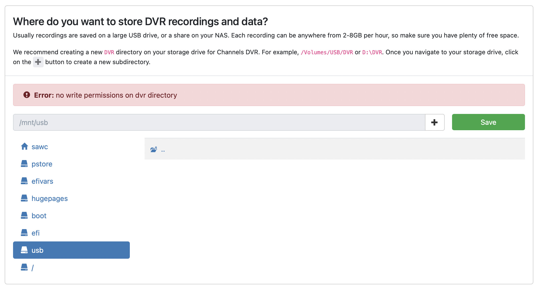

I setup a server with Ubuntu 20.04 and would like to take the USB drive I am currently using for my Channels DVR via a Raspberry Pi 4 and just restore the config and shows. I am new to Linux so I am struggling to get the USB drive mounted in a read/write mode. I got it mounted with some fstab settings I found but I get an error when I am at the step of where to store DVR recordings and data. I am trying to pick /mnt/usb/ and it tells me Error: no write permissions on dvr directory
From what I read it's because the drive is mounted as root but Channels is running as my user? How do I get it to auto mount the USB drive after reboots so that Channels can read and write to it?

Give your user permissions for the folders on the drive, and put the drive in your fstab.
As I said, I am new to Linux. What would those commands be? I am working from an SSH terminal.

Sorry, I missed that. To grant yourself ownership/permissions, and assuming the drive is mounted at /mnt/usb, then:
sudo chown -R USER:USER /mnt/usb
will give your user full ownership and control of everything on the drive. (Replace USER with your username, though.)

You need to mount just the exfat partition, which should not require any use of chown. I think maybe mount option to set the user is what's missing
Yeah, I was mounting the UUID for the exfat partition. I am sure you at right it is just some kind of option I am missing in fstab.
It was something like
UUID=uuid_for_exfat /mnt/usb exfat defaults 0 0
I tried a few variations with uid= and gid= but they were for sure wrong because after saving and using mount -a it would error at that line.

You're missing the type field in your fstab:
UUID=... /mnt/usb exfat defaults,uid=...,gid=... 0 2
You may want to check out the Arch wiki entry for fstab, as their documentation is pretty great, and applicable across most distros.

I haven't rebooted yet to ensure it automatically mounts at start up, but I believe I got it. I was able to get past that step in the setup. I was on the right track earlier, I just had the UID and GID in the wrong place.
Thank you all so much for your help and insight so far.
It came back after a reboot, success!
