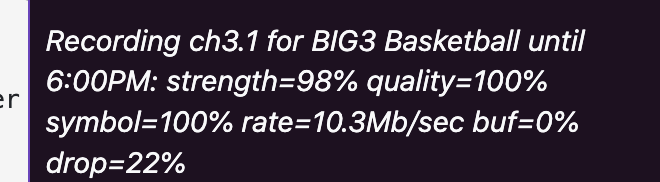

Having a strange issue today. Noticed this morning a bunch of my recordings were showing drop% in the status, both HDHR and m3u sources. Figured it was me so I started troubleshooting.
My main CDVR is standalone, alternate is in Docker. Tried both, same drops. Swapped tuner priority around between my 4 HDHRs, same thing on all of them. Then I tuned an OTA channel directly on my client (bypassing CDVR entirely) and it played clean, no drops at all. Finally I rolled back a couple of pre-release versions thinking that it could be something related to that but the same issue happened.

Here's the weird part. If I restart the CDVR service, every rec that was showing drops comes back clean with zero drops and stays that way. But the second I layer a new recording on top, that new one starts dropping right away. The ones that were already running stay perfect.
My guess is the drops are happening at the very beginning of the tune while CDVR is stuck waiting on those contentdb timeouts. Once it gets past that, the rec runs fine for the rest of its window.

Ahh Try OTA... Below is what happened for me over the course of the last 2 min...
*Recording ch3.1 for BIG3 Basketball until 6:00PM: strength=98% quality=100% symbol=100% rate=9.1Mb/sec buf=29% drop=0%*
*Recording ch3.1 for BIG3 Basketball until 6:00PM: strength=98% quality=100% symbol=100% rate=11.5Mb/sec buf=70% drop=0%*
*Recording ch3.1 for BIG3 Basketball until 6:00PM: strength=98% quality=100% symbol=100% rate=11.8Mb/sec buf=100% drop=17%*
*Recording ch3.1 for BIG3 Basketball until 6:00PM: strength=98% quality=100% symbol=100% rate=10Mb/sec buf=100% drop=38%*
*Recording ch3.1 for BIG3 Basketball until 6:00PM: strength=98% quality=100% symbol=100% rate=10.8Mb/sec buf=100% drop=51%*
Then once the timeouts pass the avg drop stats dwindle down...
