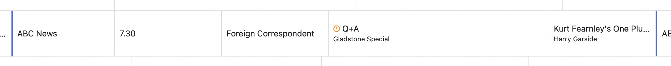

The screenshot below shows the relevant section of the guide: I have extended it further to show that it is showing a blue line (New tag) on some episodes, but not others. The "Q+A", and the "7:30" episodes should also be tagged as New.
