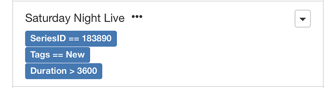

This is how I got around that issue with SNL recording the earlier version with rerun content:
Here's how I record SNL:

Thanks both of you for the SNL recording tips. I thought I had already changed my recording settings, which is what made it frustrating. So going back to that I can see I must have not saved my changes. A frustration of my own making.
