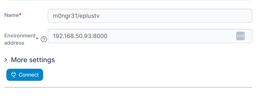

I tried this ..
Error Failure Get "https://192.168.50.93:8000/ping": http: server gave HTTP response to HTTPS client
change https to http in the browser
No matter what I try it defaults to https ...
Im not sure what "environment address" is supposed to be. What is that url and port 8000 ?

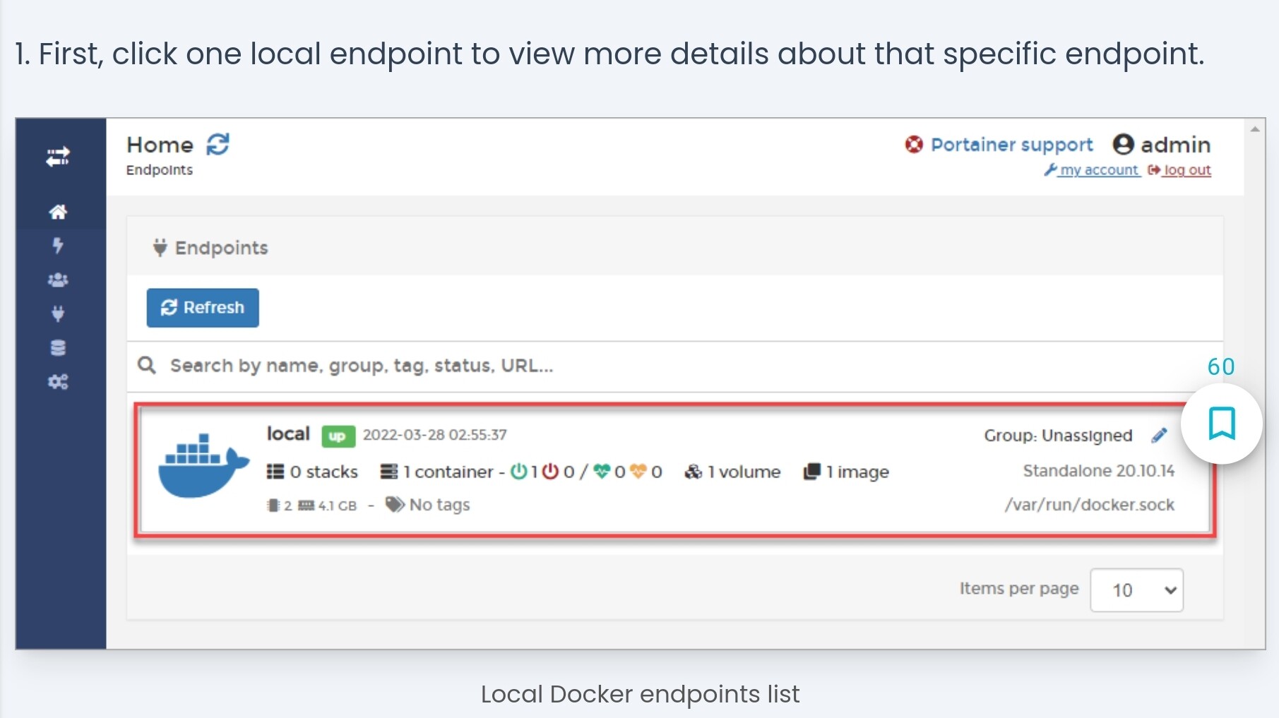

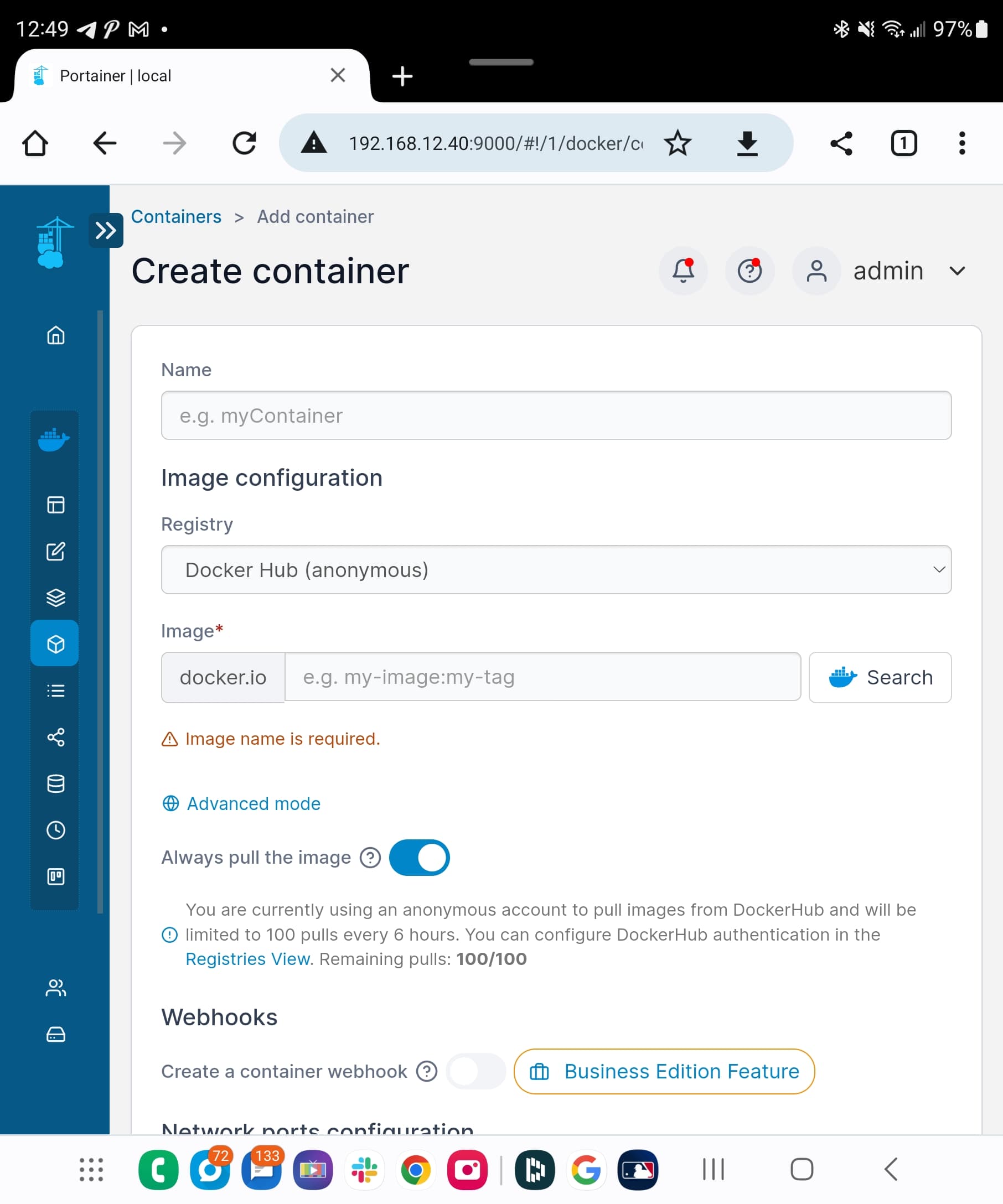

Are you trying to add a container? If so you wouldnt do it under add environment, that is for adding another docker server.
You need to add a container
@slampman

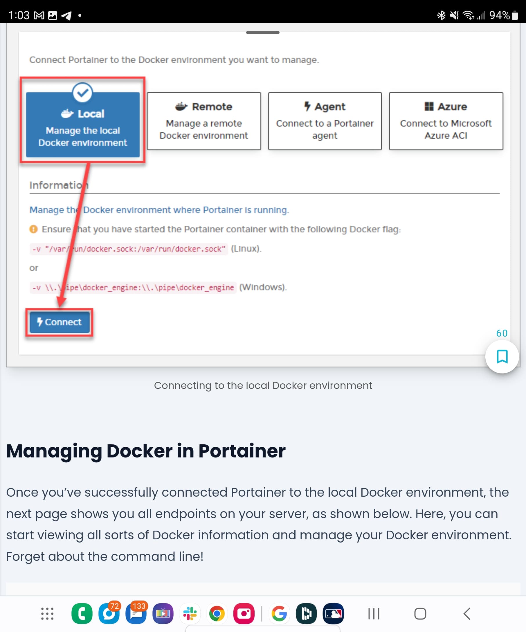

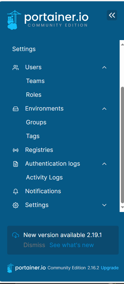

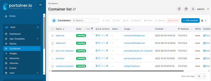

I must have the wrong portainer installed I do not see what your screenshot shows ....

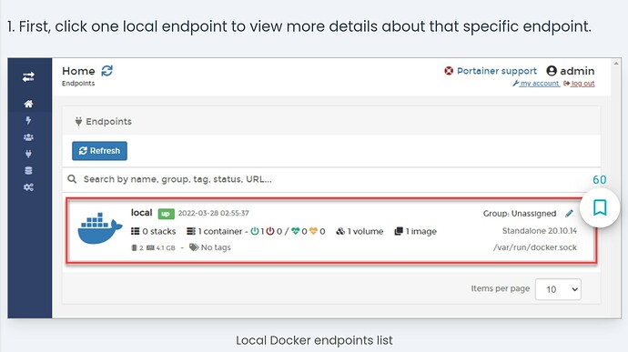

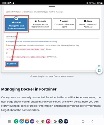

You have the right serup. Did you connect to your local docker instance? Sounds like it isnt managing your environment.

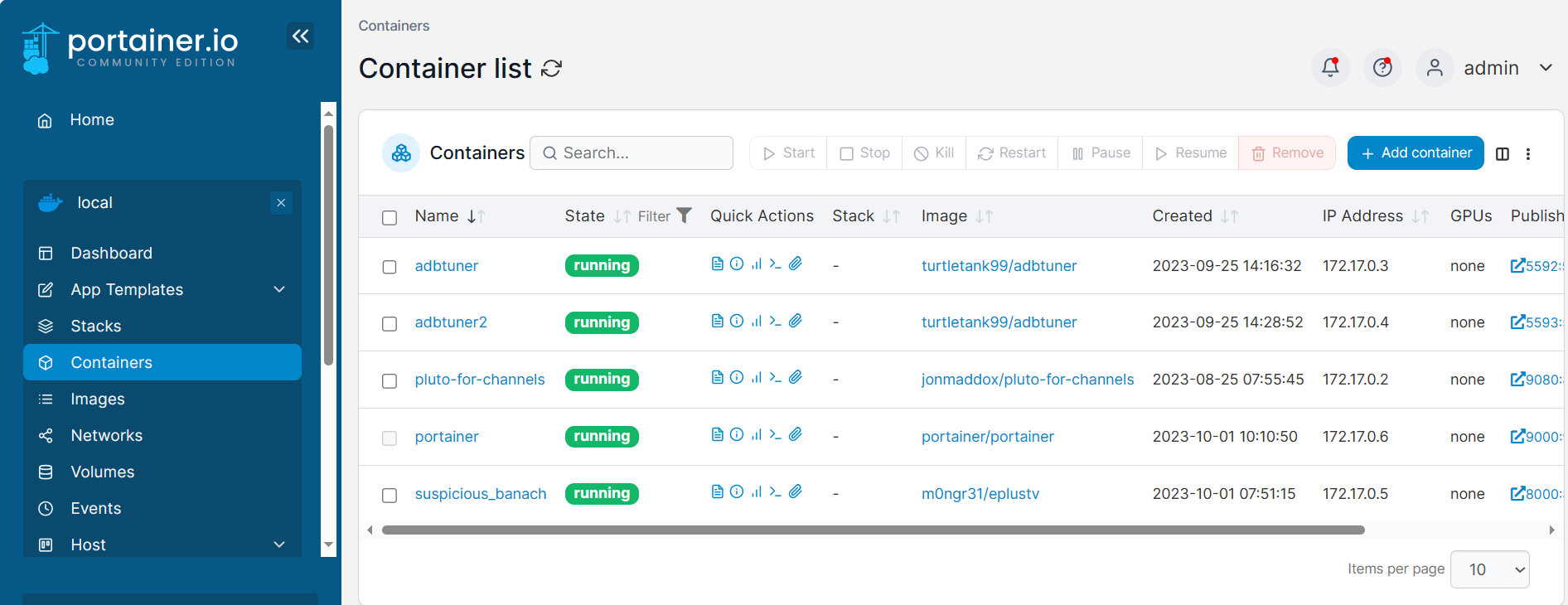

You would click containers here
Thanks a lot that did it .... much appreciated.
