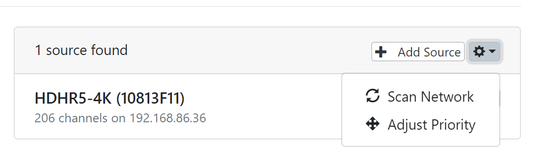

Click Scan Network on your DVR web UI so it finds the new IP of your HDHR
I tried that here. No luck.
