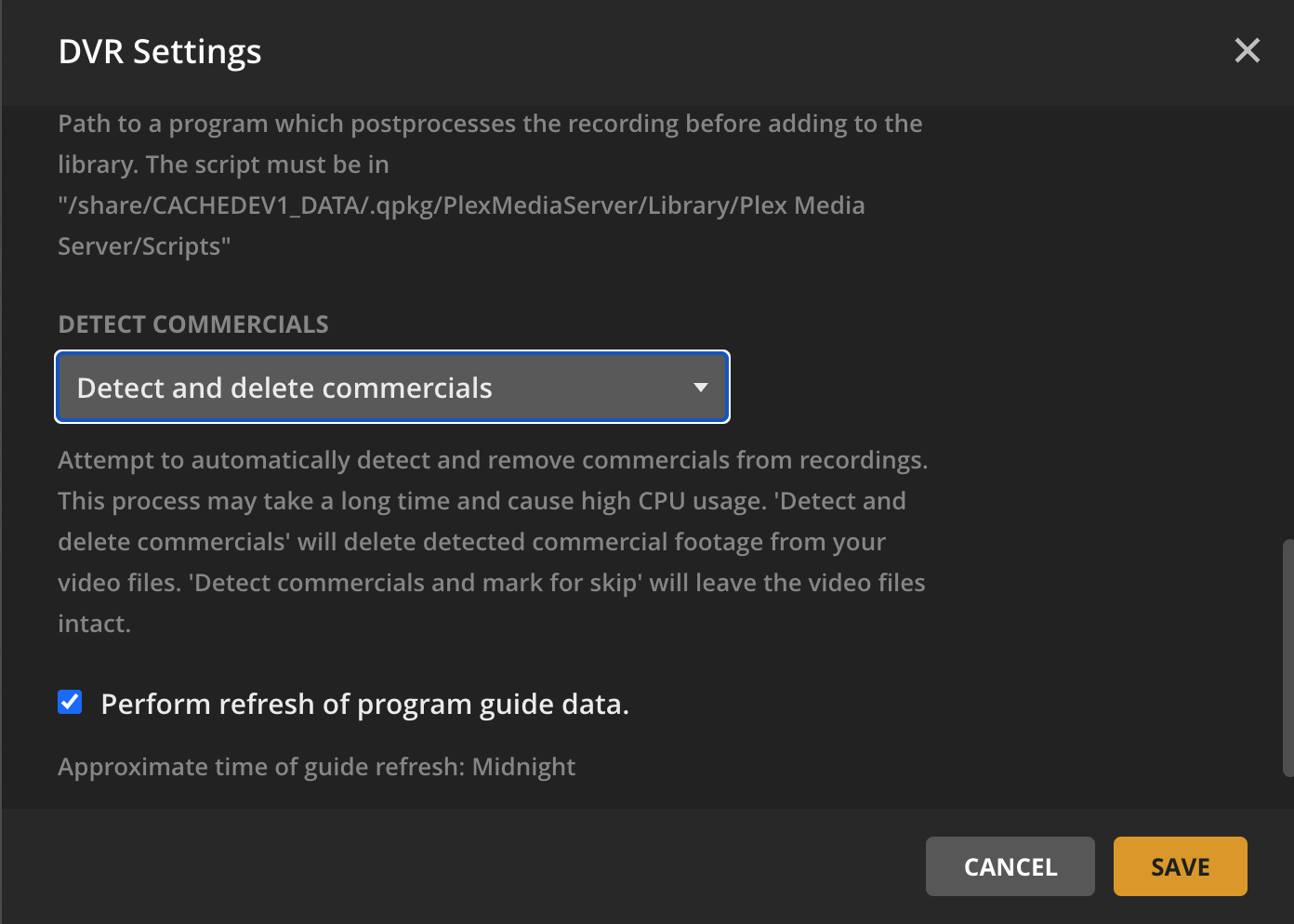

I guess I do disagree with the "nor should it be" when plex DVR gives three options for commercial detection/removal
  • Disable
  • Detect and mark for skip
  • Detect and delete
I would say choice would be the optimal direction for users, not a flat out "nor should it be" approach. the three options plex DVR gives Allows for people to choose what they want without simply cutting out the possibility of the feature.

Well good news for any Plex users. I was able to use xTeve on my Qnap NAS to essentially "bridge" the Channels Dish and Locast programming to my Plex DVR. I set up xTeve with
Playlist: http://127.0.0.1:8089/devices/ANY/channels.m3u
XMLTV: http://127.0.0.1:8089/devices/ANY/guide/xmltv?duration=3600
Then created a new DVR on Plex using the local IP and xTeve port http://127.0.0.1:34400/
So far its been working great and now i can record programming from my Dish account and/or Locast and Plex DVR is performing automatic comskip after recording and storing all of my commercial free shows as expected.
Fyi the comskip results with Plex has been very satisfactory, we ocassionally see about 1 second of the commercial before the show resumes. I did spend some time tweaking the Plex comskip.ini file to refine the behaviour. It was nice to have this level of control and still have all shows playable with no commercials.
So now, since our location prohibits any OTA reception, I have both Dish and Locast programs feeding into my Plex DVR setup
