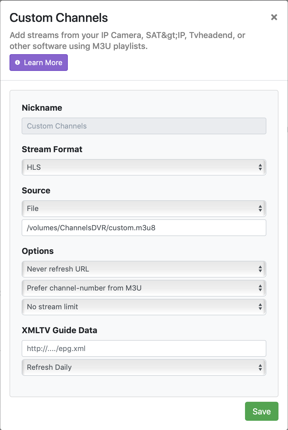

I created a file called custom.m3u8 on my Channels DVR volume. I have the following detail in the file:
#EXTM3U
#EXTINF:-1 channel-id="Newsy" channel-number="101" tvg-logo="https://www.newsy.com/img_new/header/newsy-logo.svg" tvg-name="Newsy" tvc-guide-title="Newsy",Newsy
https://content.uplynk.com/channel/4bb4901b934c4e029fd4c1abfc766c37.m3u8
Then I added a Custom Source with the following configuration:
I hope this helps.

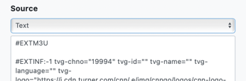

TextEdit works for this. But you don't even need to make a custom file, you can instead just paste the text into the field too, after choosing "Source: Text:"
CleanShot 2021-10-04 at 11.08.44
