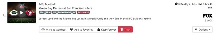

Watching the 49r's/Packers game last night and Channels DVR says it had an interrupted recording right after the 3rd quarter. I don't believe I've ever had that happen before with an OTA tuner. I was watching it on another HDHR tuner (SageTV) sitting right beside the HDHR tuner feeding Channels DVR.

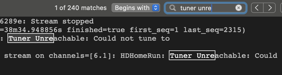

2024/01/20 21:30:14.458260 [ERR] Failed to start stream for ch6.1: HDHomeRun: Tuner Unreachable: Could not tune to http://192.168.254.231:5004/auto/v6.1 after 30s
2024/01/20 21:30:14.468836 [HLS] Couldn't generate stream playlist for ch6.1-d1072F287-1ab29766289e: HDHomeRun: Tuner Unreachable: Could not tune to http://192.168.254.231:5004/auto/v6.1 after 30s
The transcoder tried hard to deal with the corruption but it was ultimately too severe to recover so the remote streams were negatively affected. Watching in original quality at home would still have worked fine.

How many times did the software attempt to retune and correct the problem? Differentiating from the various family members that were trying to again tune the game from the guide.
240 times
Over what period of time
It's all in the log.
