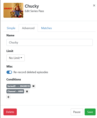

Previously I could edit the stations used for a pass with something like this:
CHANNEL < 100 (MY ATSC 3.0 channels performed horribly)
I wanted to add
CHANNEL > 3
CHANNEL < 103 (effectively replacing 2.1 with 102.1)
...because now I have more options from another city that actually are usable.
LESS THAN and GREATER THAN are now missing for CHANNEL in the advanced pass settings. The workaround was to EXCLUDE a huge list of channels. Any way to add back the < and > settings for CHANNEL?
That looks like a bug and was dropped on the Web Page. Needs to be added back in as it is a big part of setting up passes.
Was working before ...

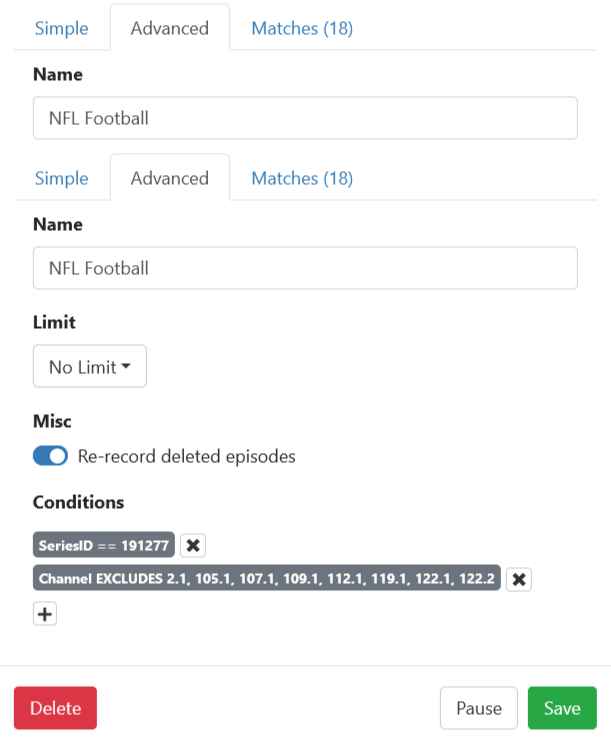

I changed it to this as a workaround:
As soon as 1pm hit it started recording on 122.2, which should be excluded as far as I can see.
WARNING: I have quit caffeine recently so I could be missing something obvious. :grimacing:
If you want 102.1 just put it in the pass
Wishful thinking, but you can't add multiple channels separated by commas
You have to use separate Channel EXCLUDES for each channel.
4 different networks telecast NFL games.
Wishful thinking would be the < or > that worked for 2 years now.
[edit] I had to go back and test again, thought I did try separate EXCLUDES. Turns out I tried adding stations to include with ==
Adding the next one would delete the previous one. In my case INCLUDES was easier since there's only 4, versus 3 times as many EXCLUDES.
Thanks!
