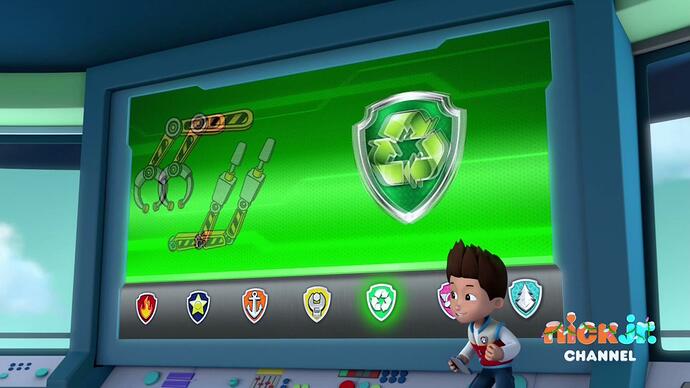

NickJR, do not know where to stream it on line, but in Channels, it always has the issue even during adds. (Paw Patrol pretty much is the only thing they air it seems, 99% of the time i look at that channel, that is what is airing, lol)

I guess the network rep you are apparently communicating with, may have tuned to station stream only for a few short moments, at a time it was not having the issue, like during certain adds. The video file I provided proves there is an issue with NickJR, however, I can not also provide web stream capture, with out the url to view in browser as i have with the other networks.
EDIT: When i play Nick JR via the Channels DVR admin Web GUI, in the smaller window player mode, the issue is barely noticeable, very hard to see it. Full screen, it extremely noticeable. Probably due to the video window size being much smaller i guess. However, maybe something in how the video is stretched when being upscaled/up-sized, whatever is done when video is full screened that could be part of the issues. The network rep may also have not viewed the web stream full screen perhaps.
