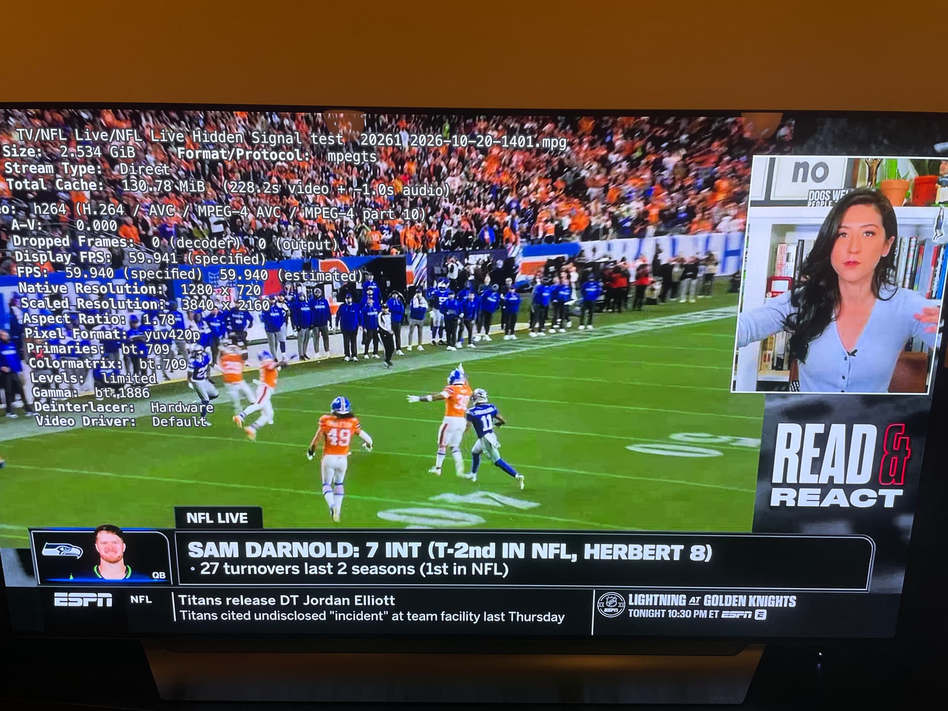

I have an NFL Live recording from October 20 that plays without sound in Channels on Apple TV. The audio section of the playback stats is completely blank
The same original file plays with audio in VLC. The DVR server’s media information identifies a Dolby Digital 5.1 audio track. I tried both Default and Legacy audio drivers and restarted the app, with no improvement.

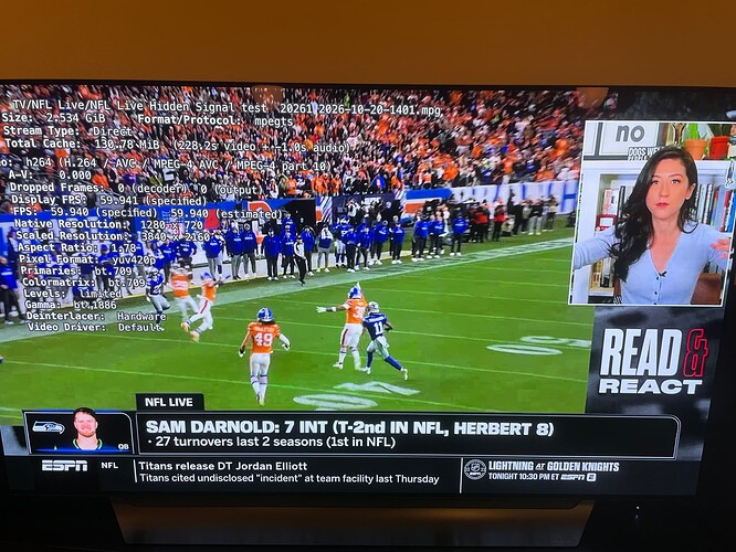

A clip covering approx minutes 44–49 showed the bug. It initially had audio, including after several seeks. After another forward seek, audio stopped. Enabling Show Stats showed no audio information (Show Stats wasn't enabled from the first, only after the audio stopped).
Seeking backward or elsewhere didn’t restore it, and exiting playback and reopening the clip still produced no audio.
This clip was copied directly from the original MPEG-TS packets, without re-encoding or remuxing. I submitted fresh Apple TV diagnostics at approximately 10pm Mountain Time after the failure.
Filename uploaded: NFL Live - Hidden Signal - 2026-10-20 - minutes 44-49 - audio change.ts
One other note: after fully backing out and reopening the clip again, audio returned, then went silent again. This time Show Stats was enabled throughout, and the audio information remained visible after sound stopped.
