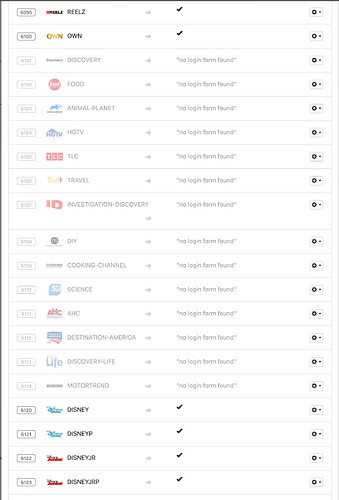

Sometime yesterday, all the Discovery channel channels stopped working. I'm getting the dreaded "no loginform" error. I've tried reentering my password and logging in to the discovery channel web page and viewing content there and then switching back to channels. Nothing doing.
Is anyone else seeing this?
Can someone help?

Update to Pre-release server, and then try again, then re-scan if still not work. DirectTV has bunch of issues lately after cyperattack.
Ok. I already had the latest pre-release. I did notice that AT&T/Directv forced me to reset my password. So possibly related to the attack. I've reset the password in channels. But so far, it still isn't working.
2023.03.13.2303
You have to re-scan. Or u can try deleting the TVE source and re-adding it.
Other wise, standard practice is to submit diags from the server, so they can see what is happening.
Also posting the screen shot the server takes of the error can help.
Sometimes,. there is a Capatcha or Security pop up that prevents TVE login.
2FA also is NOT suported.

Only thing I hate about deleting the source is I've got my favorites saved and arranged the way I like. But I guess since I'm not getting most of them now, I will need to do that. I'll post a screen grab here too

It just shows a black screen.
I removed the existing TVE entry for directv stream and tried recreating it.
Now I no longer have access to directv stream at all via Channels TVE
The error I am getting is

'Storage.getCookies' wasn't found (-32601)
Update chrome on the troubleshooting page
I'm not sure I follow. I'm doing this via my synology 218+ and Safari on my Mac
Support > Troubleshooting click the green button
I don't see a link to support from this page. So I'm still puzzled about where to do this
http://10.54.1.108:8089/admin/troubleshooting
oh. I'm so sorry for not getting it. I'm going there now.
Thank you so much for your help, Tmm1. I really appreciate it. I seem to be back up and running as expected with all the discovery channels restored.
