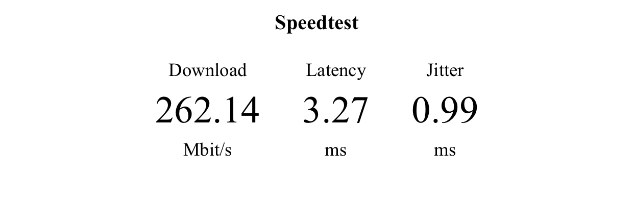

Okay, I’ve submitted my diagnostics. Seems 729p channels didn’t stutter as much as 1080i. Attaching my speed test results.
