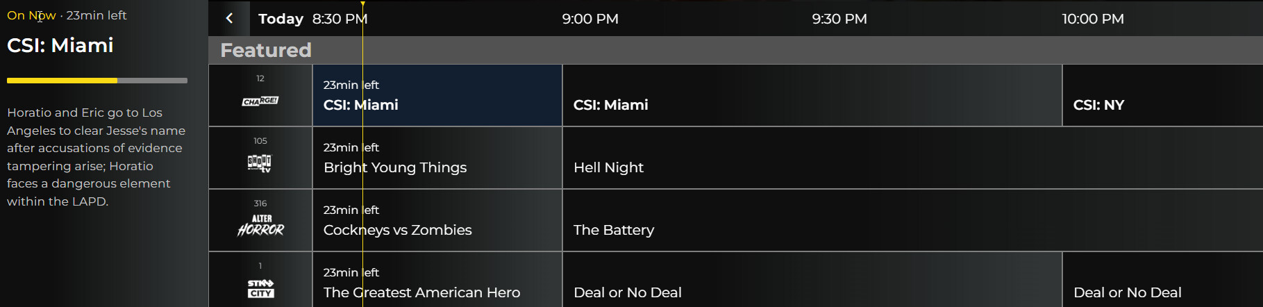

Is it just me or is this normal for Stirr? If i go to stirr.com and look at their guide, they show the show title and description as expected.
In the channels guide I don't any titles or descriptions.
Stirr.com guide
my Channels guide:

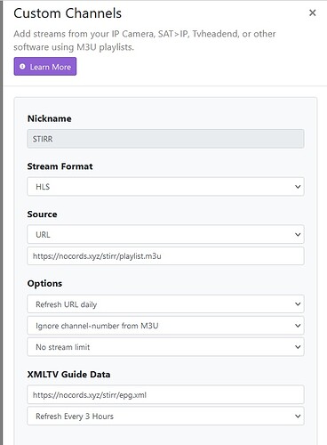

Settings:

The settings look correct.
Try redownloading XMLTV from the sources dropdown and check the DVR log for errors.

Your settings look funky to me. These are mine, and it works perfectly. I suspect since you are trying to FORCE your channels up to above 20000, the epg can't find them.
Try mine just for the heck of it, Reload after making the changes, and RE download the guide (you might need to wait a few minutes after the full guide download, for it to index). See if you now magically get proper guide. IF YOU DO, then we need to figure out why YOUR custom settings are causing issues with the guide data matching.

Just check my DVR logs and am seeing this error.
2022/10/26 10:23:33.540168 [ERR] Failed to download XMLTV-Stirr: xmltv fetch: 404 Not Found
I can browse (in chromium) to that url on the DVR machine and it downloads the file and when I open the file it contains valid data.

You entered the epg url incorrectly. There is an extra space at the end
Damn copy and paste.
Thanks
I thought that was corrected with Very minor issue with URL entry on Custom Channels form. :slight_smile:
It was for m3u but not xml. The latter is now fixed with the next build.
