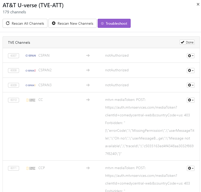

"Not Authorized" & "Media Token" errors on majority of channels

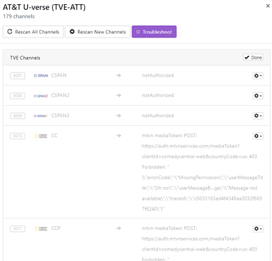

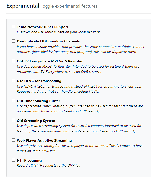

Most channels not working now, some still work but I'm down to a small handful left. Noticed when my wife informed me Hallmark channel was not working, then looking at the server I'm getting either "Not authorized" or "media token" errors on a bunch of channels. Guide data seems to be downloading correct, error happens when trying to stream. Ive tried each experimental option, shutting-down and restarting server after each change but no difference (in regards to errors). Then I tried uninstalling entire channels server and reinstalling with no improvement. Ive tried re-scanning the channels, I've tried re-scanning individual channels that are throwing the errors. Ive also verified through some of them that I can log in on their website and stream using my provider credentials. Ive tried using the pre-release version but with no improvement. My ports are open on my router and the firewall rules are correct on my PC. I've been a channels DVR user for years and cant remember having this many issues with so many channels.
I'm throwing in the towel and asking for help. I do not have any experimental options selected and after a clean reinstall I'm now running latest stable-version ( 2024.03.27.1935 ) im running Windows 10 Pro as my server.

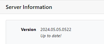

Update to the latest Channels DVR pre-release version.
Many TVE issues have been fixed since the latest stable.

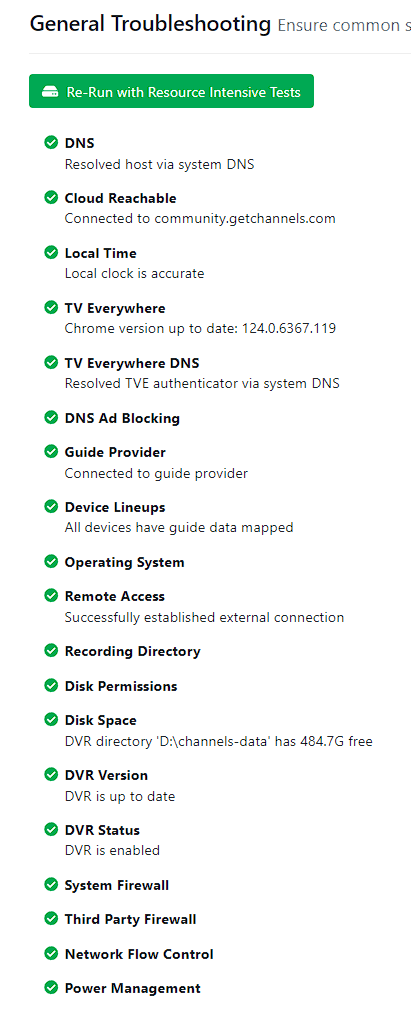

Run Support > Troubleshooting from the DVR web UI.

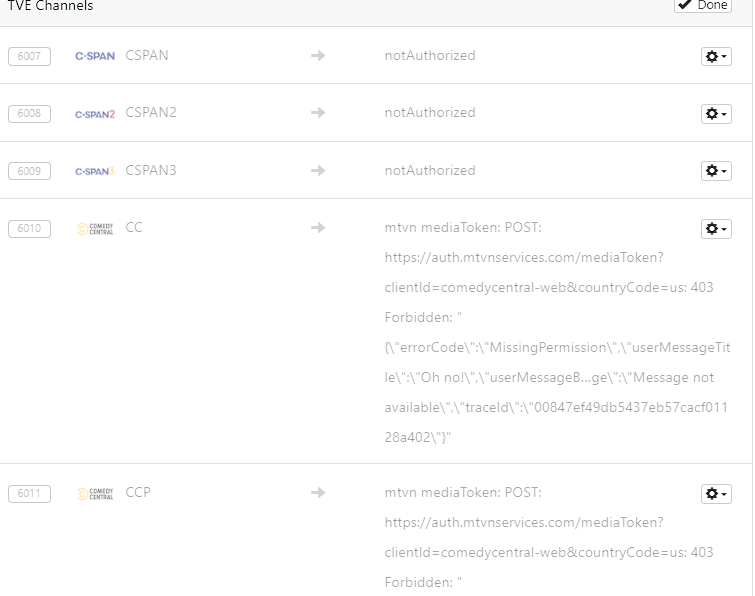

Rescan a single channel in error, like Comedy Central.

Still... I just updated again to latest pre-release for you. Ran Support/Troubleshooting and no errors produced. Same channels still producing same errors, I re-scanned them again - no fix, I re-scanned them individually - nothing different.
Are you getting any channels below 6700?
Have you tried doing an Update Password on the TVE source?

I would submit diagnostics from the DVR web UI Support > Troubleshooting.
Yes some of the few channels I still can watch are below 6700. I had not tried doing the Source\Update Password because like I said earlier I just deleted the entire Channels DVR install and started fresh. But just for kicks and giggles I tried it and no change. Submitting my issue via email to [email protected] but if anyone has any suggestions I haven't already tried please let me know.
