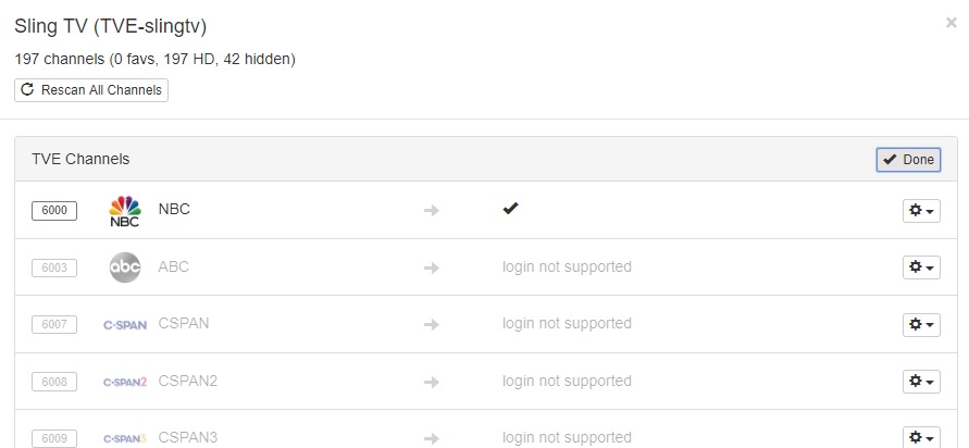

I'm not seing Fox as an option for my TVE on Sling - I confirmed that I can login via the Fox Live url, anything else I should try?
Not all cities offer fox live streams. Does it actually stream on fox.com/live (and not just during prime time)?
Yeah, I am watching our local evening news (Fox 9 Minneapolis, St.Paul) at the moment, I can try at other times of day tomorrow to confirm - FYI I did notice the URL resolved to https://www.fox.com/live/channel/KMSP/ after I went to fox.com/live

Have the same issue here with Dish. I'm able to log in directly via the website but it doesn't show in Channels. Sent an email the other day with a diagnostic attached
Same thing happening here it worked perfect before and went away. When I browse to the FOX TVE site it works perfect but not working in channels. I have Dish
Just an update I don’t see the TVE scanner even attempting a login on Fox for Dish

Yes it does work outside prime time for sure. Hard to submit diag as it doesn’t look like the scanner is scanning the Fox channel
More info... the issue seemed to happen for me when three PBS TV Everywhere streams showed up. At that point I lost my Fox one. Is there any way to fix this bug?

Changed DNS to default DNS for router and it’s all green on troubleshooting but rescan still doesn’t show Fox (6002). It doesn’t even show it on Scan as a grayed out channel. Live stream on fox.com works fine.
