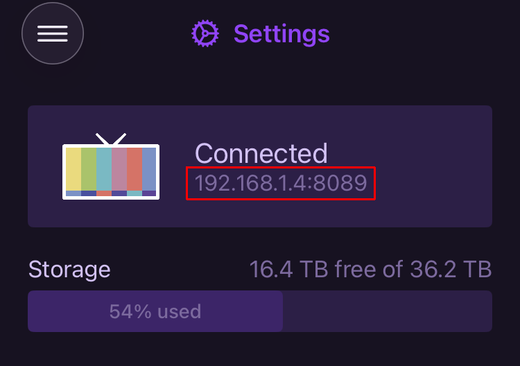

Check the Settings for the working one and use the IP address and Port it shows on the upstairs client Settings. The working one will show the IP address:Port# under Connected.
Thank you, IT WORKED. Yeah!!!!
