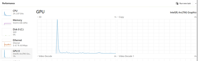

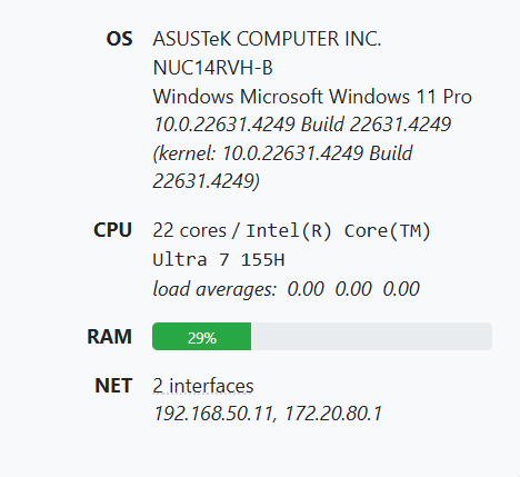

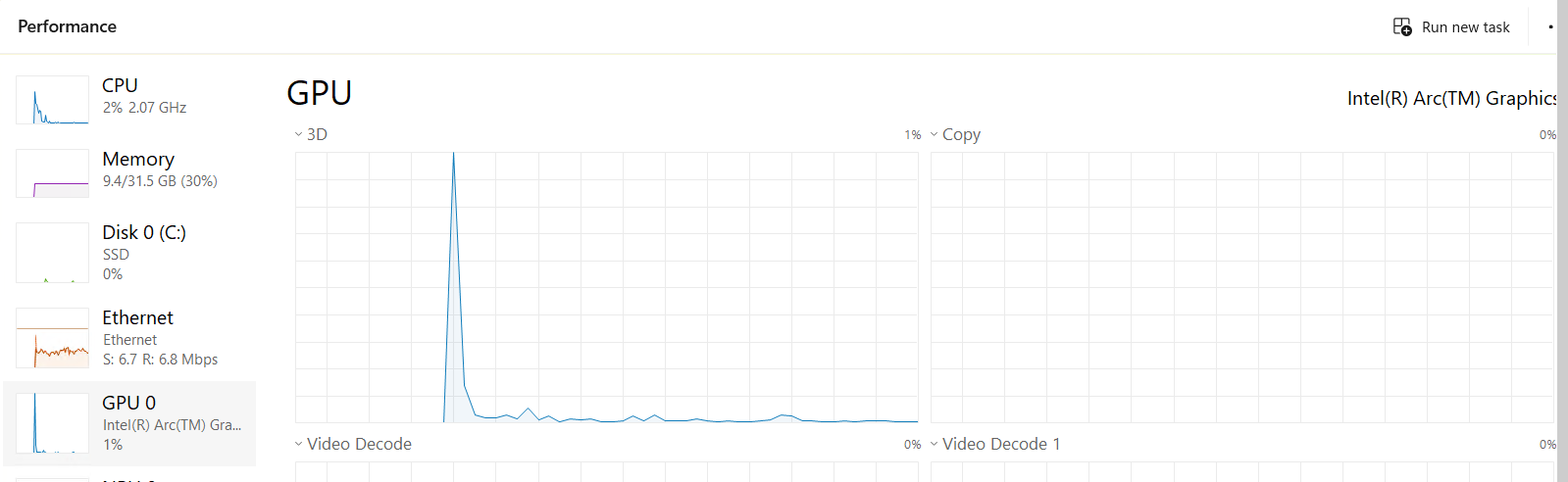

No problem. Do you, by chance, know the newer dedicated intel arc gpus work well?
I am running on a new ASUS NUC with ARC and have no problem hardware transcoding works.
So is that one built into the cpu or one of the ones that would be slotted into a PCIE slot? The server I’m using has an AMD chip so I’d have to use one that is slotted. I presume it will work though since it would use the same drivers I assume. Thanks!
Built in.
