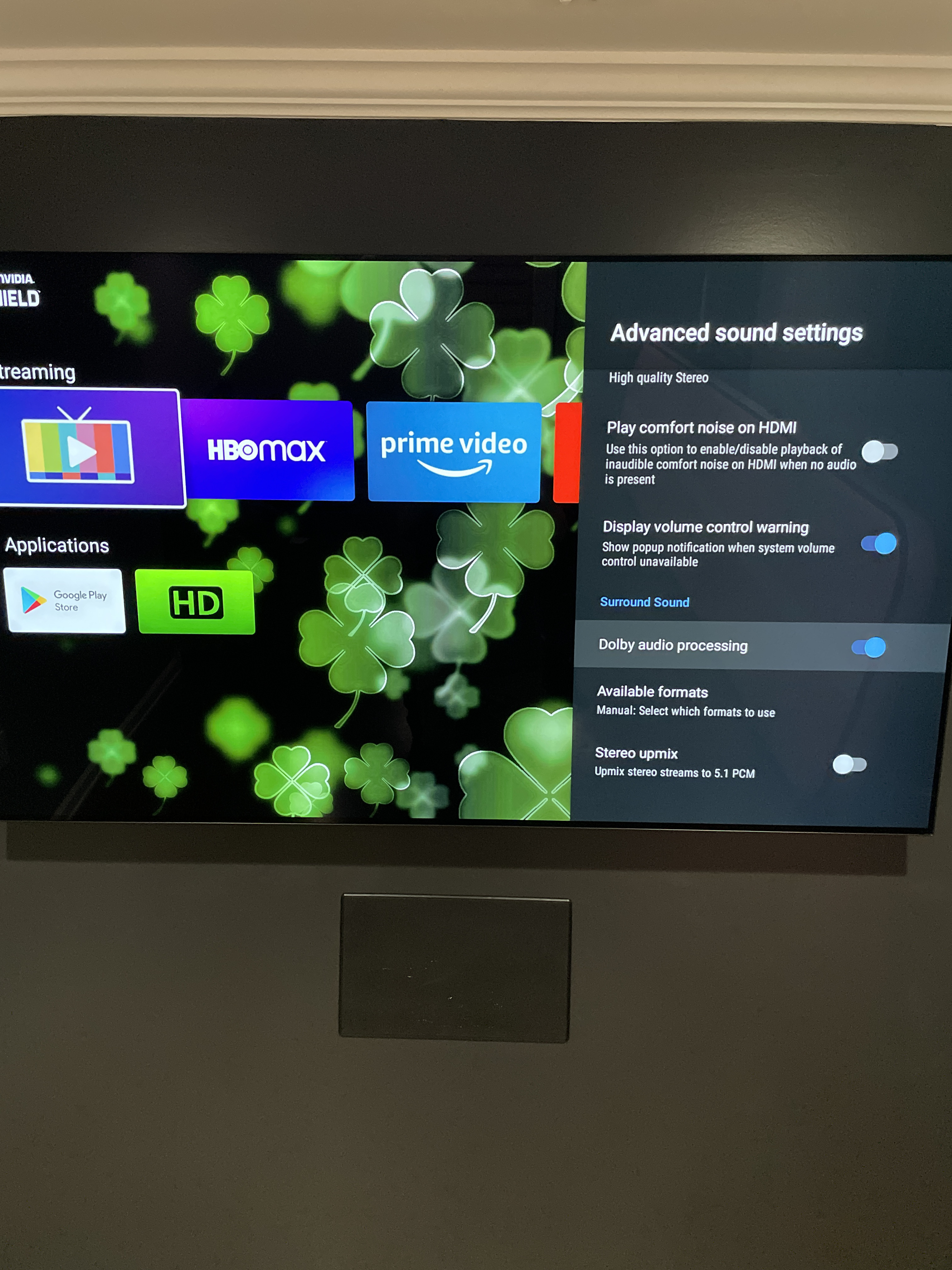

In shield device preferences>display and sound >advanced sound settings> Dolby audio processing. Turn Dolby processing off (circle to the left grey) should get you dd. If you enable this you should get Dolby digital plus. Does the Sonos support Dolby digital plus? If not you can force the shield to send dd by enabling processing then under available formats >manual select to use choose ac3 (dd)
Don’t have a Dolby Processing option. Sonos doesn’t officially support Dolby Digital Plus but you normally get sound if it is used. I’ve tried setting the format option to manual and using plus on and off and neither changes anything. Using off, auto or manual doesn’t give me surround sound from the Channels app.
Weird. Here it is on my 2019 shield pro. May be they don’t have that option on the tube. Do you have the tube?
One tube and one non tube. I’ll check the tube and see if that has the option.
Ok, tube Shield has Dolby Processing option, but off or on, I still don’t get 5.1 from Channels app.
Tried it off and on, also tried auto formats and manual formats with Dolby Digital Plus on and off, neither gives me 5.1.

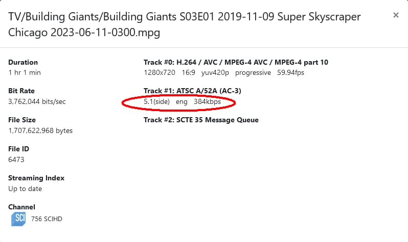

I am trying to figure out why recordings done with the capture card have 5.1 audio with kodi but not with channels dvr. In a lot of cases I get o audio at all in channelsdvr but I get ac3 5.1 perfectly with kodi and with nextpvr android client (audio receiver indicates that it detects it and all).
If you look at Options > View Details for the Channels DVR recording, what does it show?
You can also view a recorded file with mediainfo to see if it shows a surround audio track.
General
Complete name : \\DS1019PLUS\ChDVRhdhr\TV\Building Giants\Building Giants S03E01 2019-11-09 Super Skyscraper Chicago 2023-06-11-0300.mpg
Format : MPEG-TS
File size : 1.59 GiB
Duration : 1 h 0 min
Overall bit rate mode : Variable
Overall bit rate : 3 764 kb/s
Law rating : TV-PG
FileExtension_Invalid : ts m2t m2s m4t m4s tmf ts tp trp ty
Video
Menu ID : 7 (0x7)
Format : AVC
Format/Info : Advanced Video Codec
Format profile : [email protected]
Format settings : CABAC / 4 Ref Frames
Format settings, CABAC : Yes
Format settings, Reference frames : 4 frames
Codec ID : 27
Bit rate mode : Constant
Bit rate : 3 175 kb/s
Maximum bit rate : 3 375 kb/s
Width : 1 280 pixels
Height : 720 pixels
Display aspect ratio : 16:9
Frame rate : 59.940 (60000/1001) FPS
Standard : Component
Color space : YUV
Chroma subsampling : 4:2:0
Bit depth : 8 bits
Scan type : Progressive
Bits/(Pixel*Frame) : 0.057
Stream size : 1.35 GiB (85%)
Color range : Limited
EBP_AcquisitionTime : UTC 2023-06-11 09:59:26.547988892
EBP_Distance : 2.000
EBP_Mode : Explicit
Audio
Menu ID : 7 (0x7)
Format : AC-3
Format/Info : Audio Coding 3
Commercial name : Dolby Digital
Codec ID : 129
Bit rate : 384 kb/s
Maximum bit rate : 411 kb/s
Channel(s) : 6 channels
Channel layout : L R C LFE Ls Rs
Sampling rate : 48.0 kHz
Frame rate : 31.250 FPS (1536 SPF)
Compression mode : Lossy
Delay relative to video : -2 s 92 ms
Stream size : 166 MiB (10%)
Language : English
Service kind : Complete Main
Text #1
ID : 145 (0x91)-CC1
Menu ID : 7 (0x7)
Format : EIA-608
Muxing mode : SCTE 128 / DTVCC Transport
Muxing mode, more info : Muxed in Video #1
Stream size : 0.00 Byte (0%)
CaptionServiceName : CC1
Text #2
Menu ID : 7 (0x7)
Format : EIA-708
Menu
Menu ID : 7 (0x7)
List : 145 (0x91) (AVC) / 147 (0x93) (AC-3, English)
Language : / English
Law rating : TV-PG

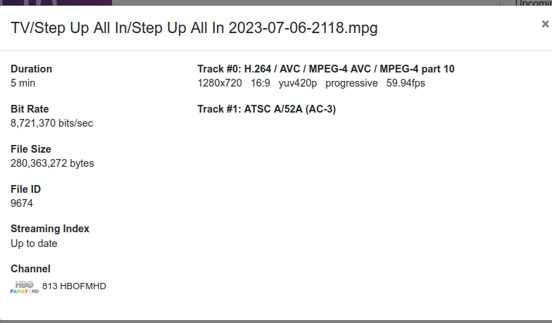

So check this out. The sample from Step up was recorded with ChannelsDVR and To Catch A Smuggler was recorded by Nextpvr.
Must be the source you recorded from then.
HDMI encoder, or ?
Both were recorded by a hauppague hdpvr 2. I suspect the encoder chip on the device is doing something funny.
