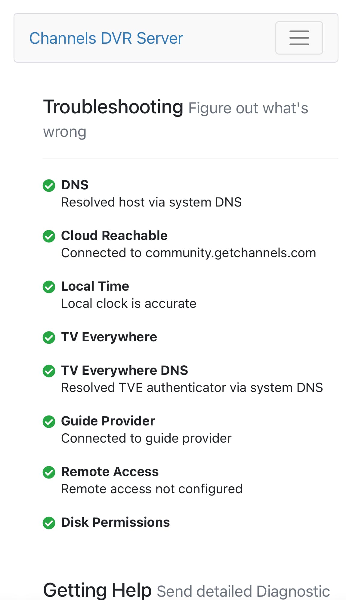

Have you checked under "Support" > "Troubleshooting" to see if everything is green? (some may not apply to you if you are only using OTA, and no TVE).

I checked under “support” > “troubleshooting” and yes everything is green. I posted a screenshot.
