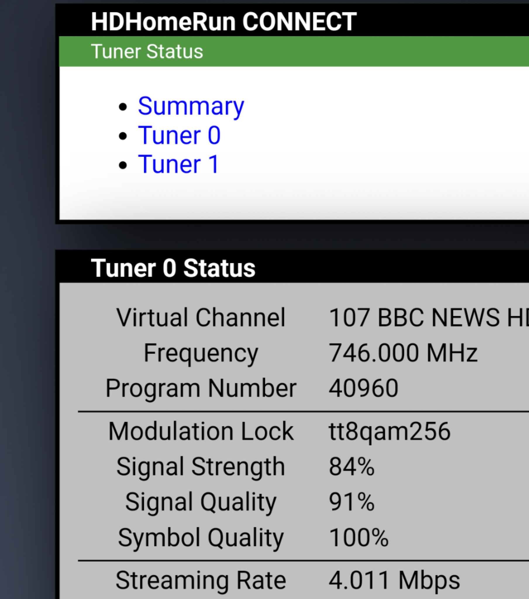

The channel quality is normally above 70%, example below of some hdhomerun stats showing a channel it was constantly freezing on this morning, and everything was 100%. Once channel freezes a simple click of the back button on remote and then play button and everything is back streaming in a couple of seconds.
Virtual Channel|11 Pick
Frequency|666.000 MHz
Program Number|22208
Modulation Lock|t8qam64
Signal Strength|100%
Signal Quality|100%
Symbol Quality|100%
Streaming Rate|1.463 Mbps
