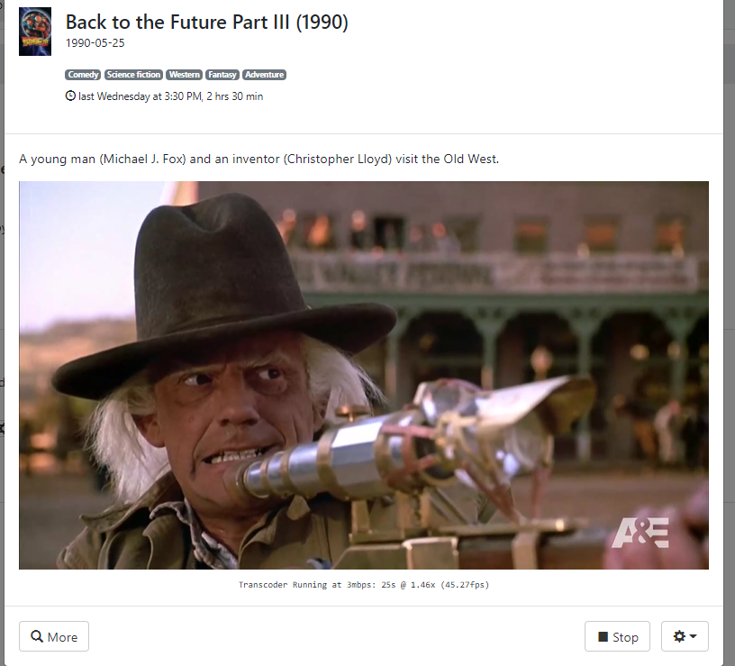

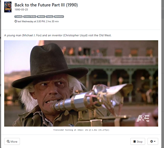

here is a screen shot of a TVE recording on the web player

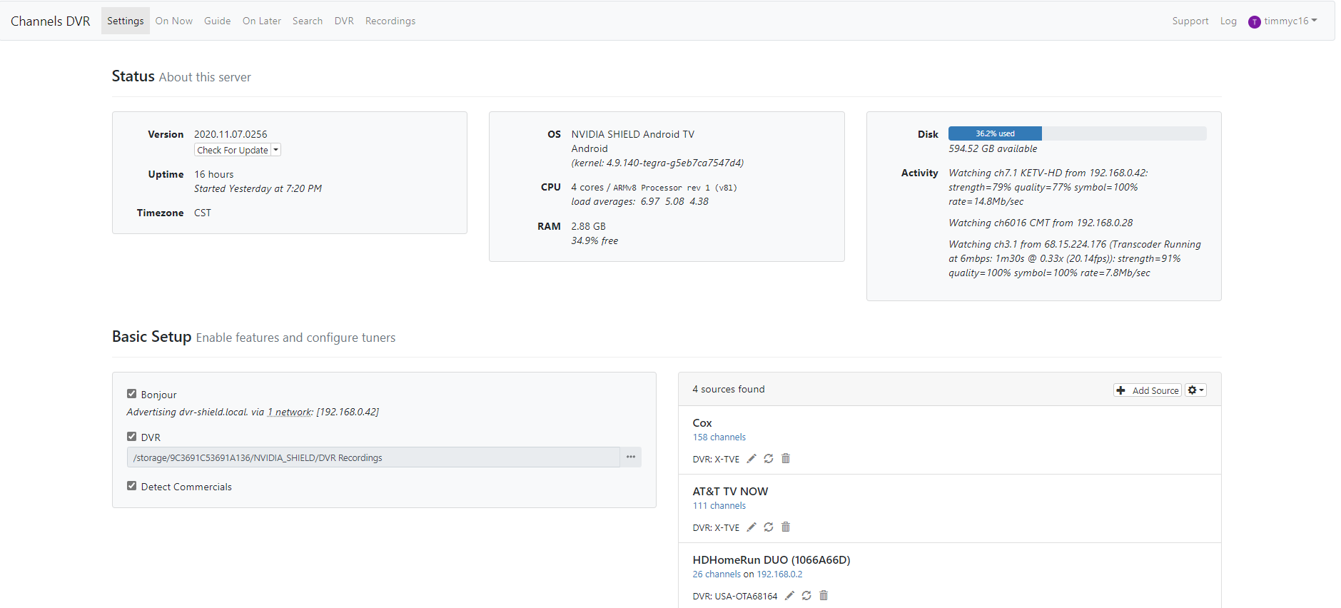

also, here is a screen shot of my DVR page if it helps
