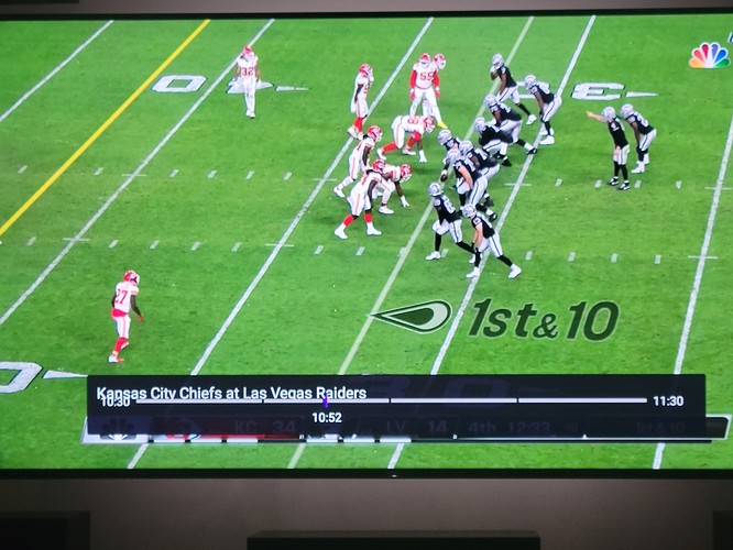

Anyone noticing picture quality issues in this beta?

I am on the beta watching live TV and I have had the screen go black and the video player just pauses. It has happened 3 times now. I thought first time I pushed a button on accident. lol I am able to fast forward and continue playing but it just pauses randomly. I just submitted video player data because I have no clue what it was in the logs.
(Also I haven't had this happen at all till I switched to beta couple days ago)
I will be watching a ton of TV today I will post if I find anything else!
Interesting thanks for the logs. If you find a recording where this happens please email it to support
I did want to note, the screen does not always turn black. Sometimes the audio and video just pauses. I wonder if its possible the video is just black when its happening sometimes?
Also I tested it and sometimes if I rewind it will pause at the same spot other times it continues fine.

// Example of performance skip
11-21 12:15:30.484 24060 24060 V mpvstats: AV: 5758.125 A-V: 0.000 Dropped: 1 Cache: 31.865s video + 31.200s audio
11-21 12:15:31.243 24060 24093 W mpv     : [ad] Invalid audio PTS: 5759.275736 -> 5763.136022
11-21 12:15:31.250 24060 24093 W mpv     : [cplayer]
11-21 12:15:31.250 24060 24093 W mpv     : [cplayer] Audio/Video desynchronisation detected! Possible reasons include too slow
11-21 12:15:31.250 24060 24093 W mpv     : [cplayer] hardware, temporary CPU spikes, broken drivers, and broken files. Audio
11-21 12:15:31.250 24060 24093 W mpv     : [cplayer] position will not match to the video (see A-V status field).
11-21 12:15:33.485 24060 24060 V mpvstats: AV: 5759.643 A-V: 3.553 Dropped: 1 Cache: 27.978s video + 25.792s audio
11-21 12:15:36.495 24060 24060 V mpvstats: AV: 5765.649 A-V: 2.304 Dropped: 1 Cache: 27.978s video + 25.024s audio
11-21 12:15:39.499 24060 24060 V mpvstats: AV: 5770.654 A-V: 0.302 Dropped: 1 Cache: 27.945s video + 27.008s audio
11-21 12:15:42.499 24060 24060 V mpvstats: AV: 5773.991 A-V: 0.001 Dropped: 1 Cache: 27.911s video + 27.232s audio
Again thanks for all the work. Sorry for the bad news :frowning: I also am sure this is a very difficult thing to track/down and fix so I do appreciate all the work.
Something strange is happening in this case where it thinks the audio is switching bitrates.
This issue would only happen with surround on.
This one generally means a blip in the recording. I would think the alpha build would react the same way with such a recording.
I did a ULTRA quick test of the repeatable section. And the alpha build with that recording and it did the same thing so you are absolutely correct! Sorry about that!
For the most part recording have been great! I will keep an eye on it, but maybe that recording was just bad! Because it had multiple issues throughout.
I can try surround sound off on the beta. To see if that resolved the weird pause issue. Because I do have surround sound on in that specific alpha build and it is almost perfect.
Also I know its a weekend :slight_smile: so thanks for the reply.
@tmm1 So I used beta all day today. Probably 4+ hours with surround sound off and no issues at all.
Then turned surround sound on and without planning my friend (who also uses channels came over) and we watched a football game. Absolutely ZERO pauses all day and if there were any skips I didn't notice it. (He mentioned 2 weeks ago he had pausing as well in channels) and during that time he noticed the signal on hd home run from verizon fios was bad.
So that might explain the bad recording and the pausing??? The dates don't line up exactly as they were different weekends but maybe they were doing upgrades in their neighborhood then mine? Either way I will 100% keep an eye on it. But I also wanted to let you know I might have blamed the beta for a possible fios issues and I do apologize!
Curious if you know if there is bad signal the video would pause? I don't care either way just curious if that could explain it?
Thanks again for all the solid work I will keep an eye on it!
It's just a bug. I'm working on tracking it down.
The pausing bug is fixed in v2021.11.29.2349 (uploading now)
