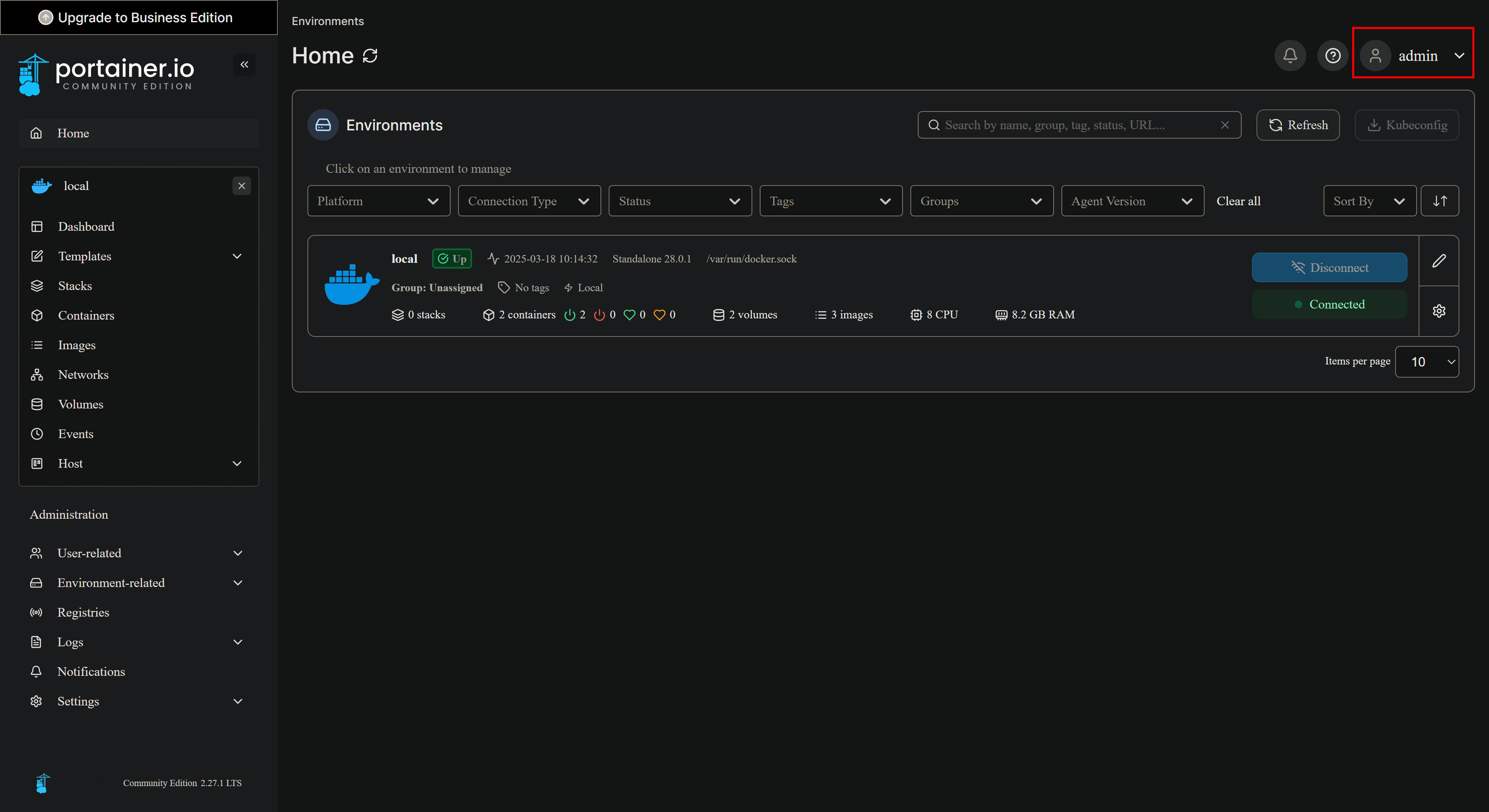

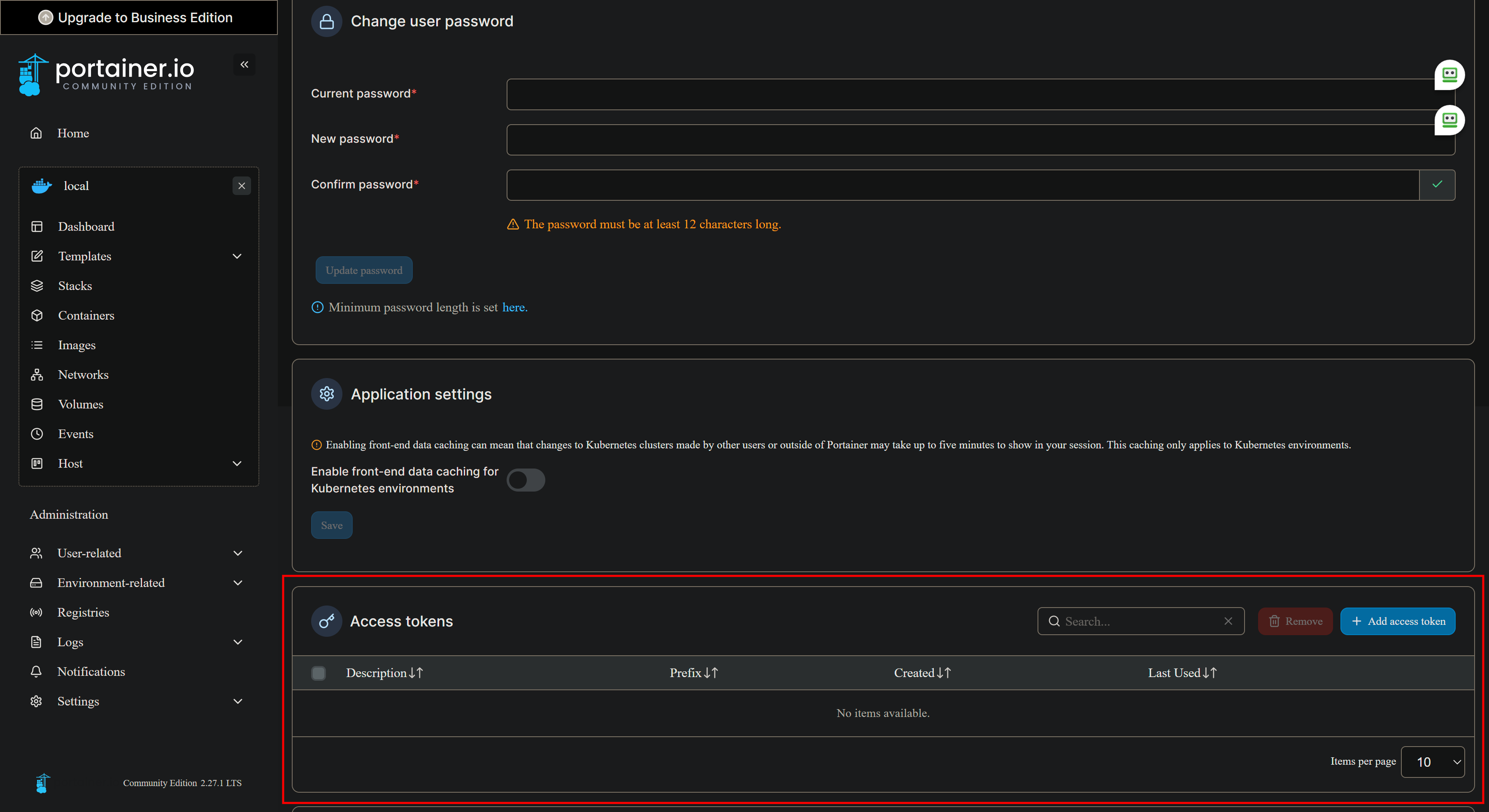

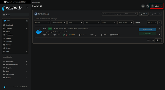

      - PORTAINER_TOKEN=${PORTAINER_TOKEN} # Generate via <username> dropdown (upper right of WebUI), "My account", API tokens.

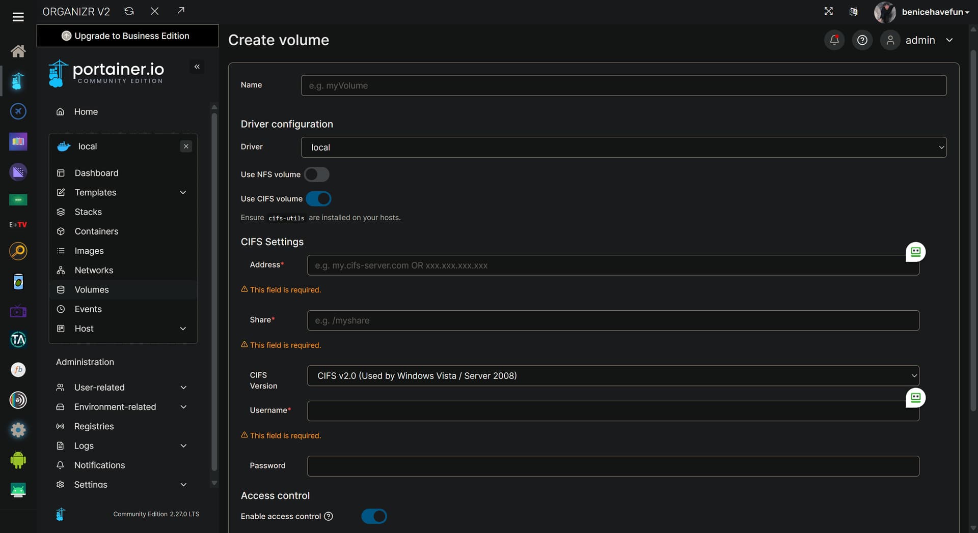

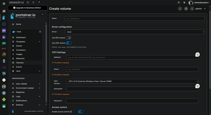

You will not need to make any changes to the Docker Compose itself. However, you will need to add two environment variables:
EZ_START=-ezstart
CHANNELS_DVR_HOST=ip.address.of.your.cdvr.server
Two things to note. First the value of EZ_START is -ezstart (begins with a dash and is lowercase). Second, use the IP address of your CDVR server only without the port number (no 8089) for CHANNELS_DVR_HOST.
Next click the Update the stack button, followed by selecting the Re-pull and Redeploy slider. Once the success message is seen, you should be able to find the OliveTin-for-Channels WebUI at http://ip.address.of.your.cdvr.server:1337
Now, select the new OliveTin Environment Variables Generator/Tester Action, and you'll be able to step through the process of adding the values, particularly those that are required. Once you click Start you'll get a new list of env vars ready to be pasted into Portainer!
Armed with this list, you can stop the olivetin stack you created and paste the new list into the Environment variables section of the Stack-Editor. You'll want to replace the values from earlier, as those are no longer required! Click Update the stack, and you'll be up-and-running.

I only have the DVR-storage and channels-dvr folders shared via SMB if that makes any difference.
OK, so I see your CDVR server and Docker/Portainer host are on different systems. Are both of those paths mounted on the Docker/Portainer host via SMB, or are you sharing them to the CDVR host via SMB?
As a side note, the PORTAINER_PORT setting is only for https, 9000 is used for http -- and that port is fixed at 9000. So, you'd want to leave that value empty or set to 9443. 9000 is used first via http.
both can be seen and browsed. I was using 9000 so as to avoid any insecure site warnings.
On the Docker/Portainer host? And if so, on what paths? If I'm understanding what you're doing, the paths that Channels is reporting, are likely not the same paths as you're using as mount points on the Docker/Portainer host -- and those are the paths we need.
So you're using http:// and port 9000, that's not a problem. But you don't want to set the the https:// port to 9000 too. PORTAINER_PORT is only for changing https://. http:// is automatically at 9000.
Given that neither of the paths reported by your CDVR server are the correct paths on your Docker host, and given your statement just above, I'm going to guess that the SMB shares are not mounted to the file system on the Docker host.
If they can be seen and browsed on the Docker host only as SMB shares, they need to be added to Portainer as Docker Volumes. Then those Docker Volumes are used as values for DVR_SHARE and LOGS_SHARE.
This is done using Portainer-Volumes. Add a volume, name it (I recommend channels-dvr for your recordings and channels-dvr-logs for the executables) and select CIFS. Then you need to specify the SMB server and SMB share names with the username and password for accessing them:
A couple of last things to do, which is to use those names, and assuming you used my recommended names, you'll be changing these two values by stopping and editing the Portainer-Stack:
DVR_SHARE=channels-dvr
LOGS_SHARE=channels-dvr-logs
And, in the compose itself, you have to uncomment (remove the #) these lines:
  #channels-dvr:
    #external: true
  #channels-dvr-logs:
    #external: true
Let me know if I'm on track here please!

The only other thing I'd suggest, is for you to create your Portainer token, and add it to OliveTin. This will open up all of the Project One-Click stuff.
That's done by going into My account by clicking on the username dropdown in the upper right corner:
Then scroll down to the Access tokens area, and add a token named olivetin:
Copy-and-paste to a secure location (in case you need it again), and then update your OliveTin Portainer-Stack env var (in Advanced mode) with your new token:
PORTAINER_TOKEN=
I could not find 'your' account; so I used my own and that seemed to work :wink:
