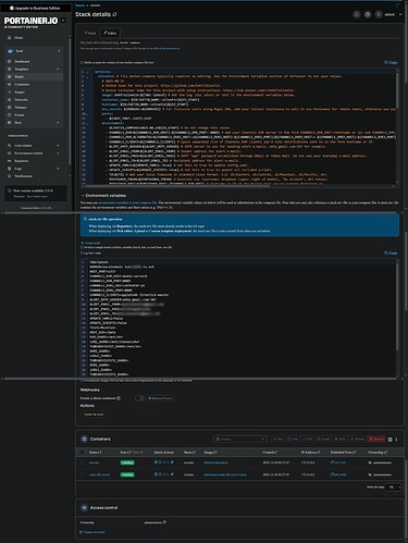

When I installed Portainer on Docker host, I had to specify http port of 9001 and https port of 9444. I specified the https port of 9444 in the in the Environment Variables Generator/Tester, which provied the following output
TAG=latest
DOMAIN=
HOST_PORT=1337
CHANNELS_DVR_HOST=192.168.68.135
CHANNELS_DVR_PORT=8089
CHANNELS_CLIENTS=
ALERT_SMTP_SERVER=
ALERT_EMAIL_FROM=
ALERT_EMAIL_PASS=
ALERT_EMAIL_TO=
UPDATE_YAMLS=true
UPDATE_SCRIPTS=true
TZ=America/Indianapolis
HOST_DIR=/data
DVR_SHARE=/volume1/NAS_SHARE/channels-data
LOGS_SHARE=/home/DINKNAS_ADMIN/channels-dvr
TUBEARCHIVIST_SHARE=/volume1/NAS_SHARE/channels-data
DVR2_SHARE=
LOGS2_SHARE=
TUBEARCHIVIST2_SHARE=
DVR3_SHARE=
LOGS3_SHARE=
TUBEARCHIVIST3_SHARE=
HOST_SFS_PORT=8080
FOLDER=/web
PORTAINER_TOKEN=ptr_fqj7iw72+3YHBFjKHuu2l7Bj25CJlJas/w3SWPvaF0I=
PORTAINER_HOST=192.168.68.135
PORTAINER_PORT=9444
PORTAINER_ENV=null
PERSISTENT_LOGS=false
Everything worked until I attempted to Create an OliveTin Stack in Portainer. Then I get the following output:
JSON response from https://192.168.68.135:9443/api/stacks/create/standalone/string?endpointId=:
{"code":1024,"msg":"Login has expired, please login again!","debug":"Err - code: 1024, message: Login has expired, please login again!","data":{},"time":0.000211975}
false
and Standard Error of
exit status 1
parse error: Invalid numeric literal at line 1, column 3
Based on the Json response, the host appears to be using 9443 instead of 9444

FYI, the docker script ran fine, here are the results:
latest: Pulling from bnhf/olivetin
ccaf924377f9: Pull complete
9a403e889e6f: Pull complete
aadf25bf1781: Pull complete
fe832f298872: Pull complete
2d837dd5ce65: Pull complete
58dd4511bf1c: Pull complete
fc51be28228b: Pull complete
9d73cc56d037: Pull complete
8ea8d7ddf5a8: Pull complete
3e33d22ff327: Pull complete
Digest: sha256:10f3f2c1e522d04550b89ed93722e3c8b2f4f73ec8b16b812a9222a12aa4565e
Status: Downloaded newer image for bnhf/olivetin:latest
58d85ca212e8efa75dacef74a1c6f1e2f4a059353f11fee61d00132fe3fbc127
After the Portainer token failure I looked at Docker Desktop. The engine was paused but the Portainer container was there. I think the engine was running when I ran the ezstart script from the Linux terminal. When I run the ezstart script from the Linux terminal does it matter what state Docker Desktop and the Docker engine are in?
