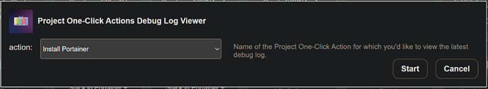

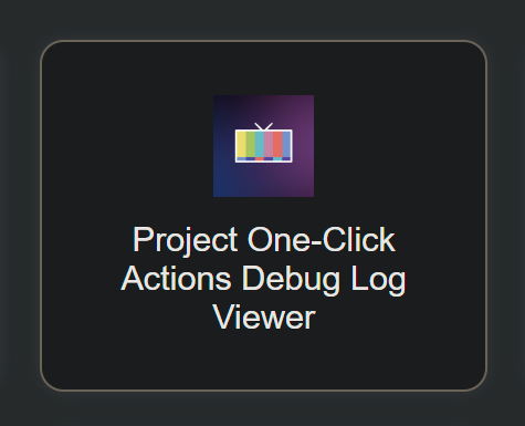

Let's take a look at the debug output. From the EZ-Start WebUI (on port 1338) run this Action:
screenshot-htpc6-2026_01_10-09_00_40
Select this debug log:
You may need to redact the password you're using in the debug, unless it's a throw-away. No need to redact your LAN IP addresses -- there's no security risk posting those.

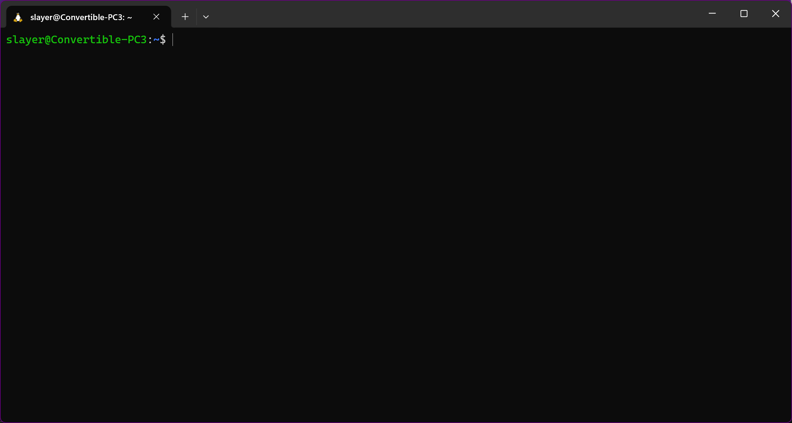

As you suggested I used /data for my HOST_DIR value. I poked around looking for this directory and couldn't find it. It is a question for me because with multiple containers, WSL, and Windows all on the same server, there are multiple root directories around. Should I be able to find /data, or will it show up only after I run certain olivetin actions?
Also, I note the ez-start container/image is still there, but not running. Is there any reason to keep it around?
Yes. Connect to your WSL Ubuntu instance using Windows Terminal and:

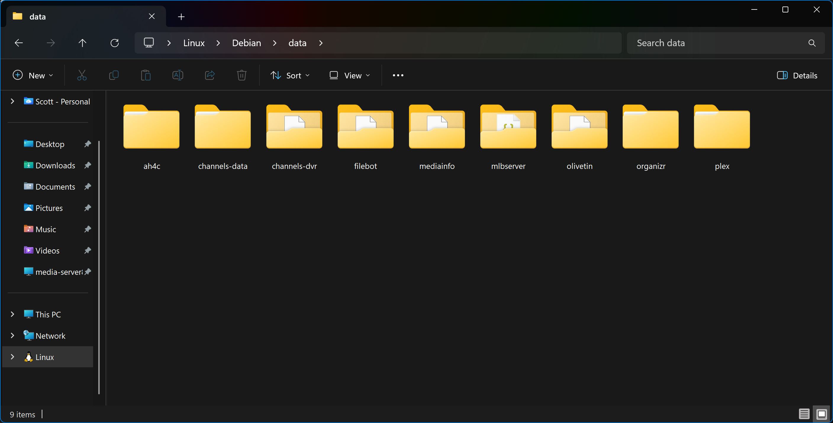

Not sure if this works in Windows 10, but in Windows 11, this is also an option:
You can stop and remove the EZ-Start container. The image though is used for the full version of OliveTin as well, so it cannot be removed.
Thanks for letting my know about keeping the olivetin image. That is obviously important.
At login I was starting in my HOME directory, thus not finding /data.

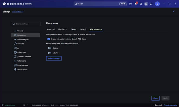

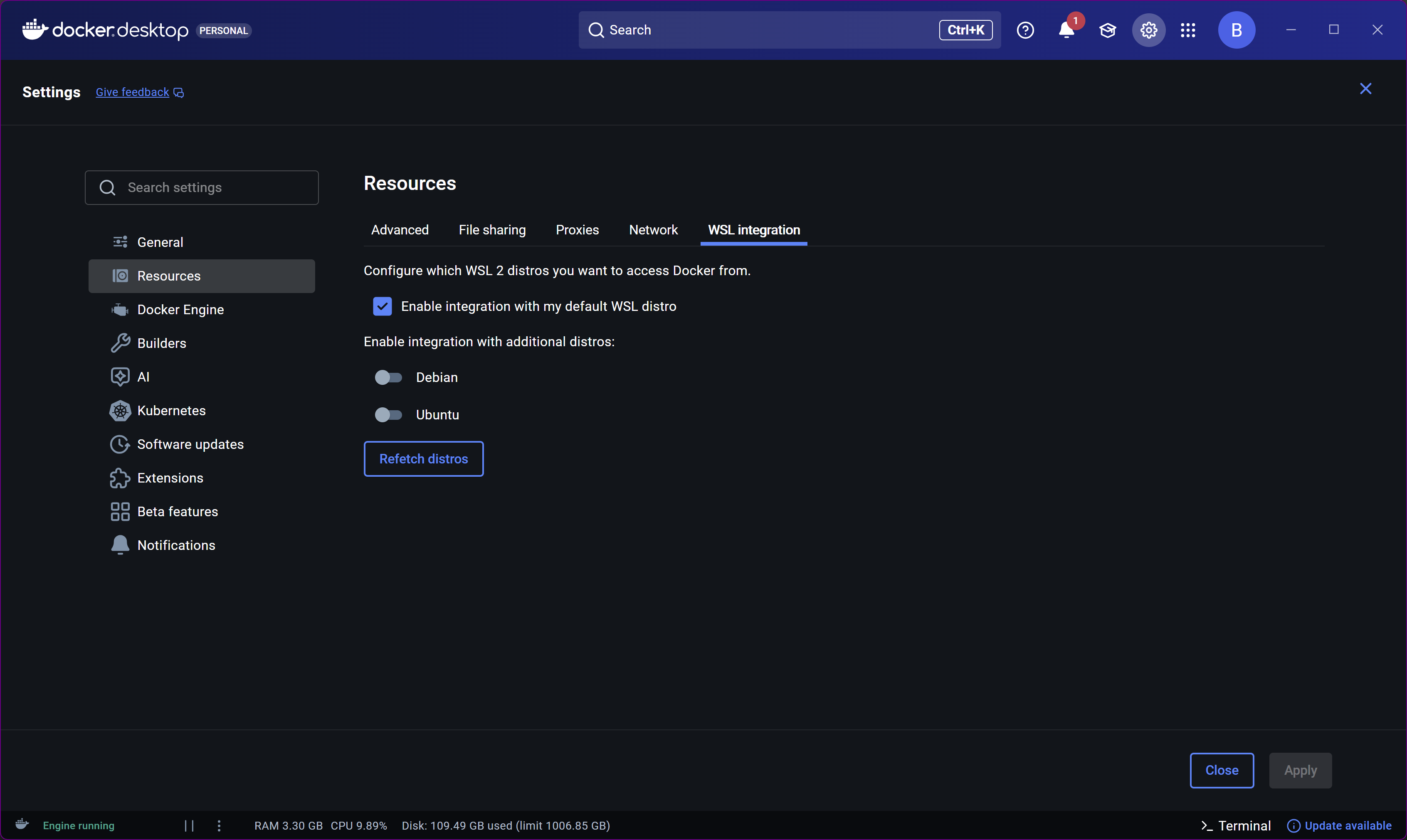

Do you have a WSL2 Linux distro like Debian or Ubuntu installed? If not, grab Debian from the Windows store, and once that's installed (use your same Windows username and password, if possible) confirm Docker Desktop has integration checked:
Then, using Windows Terminal, open a command prompt in Debian:
And paste the EZ-Start run command in...
Awesome! That worked (partially). Got these errors on the way...
