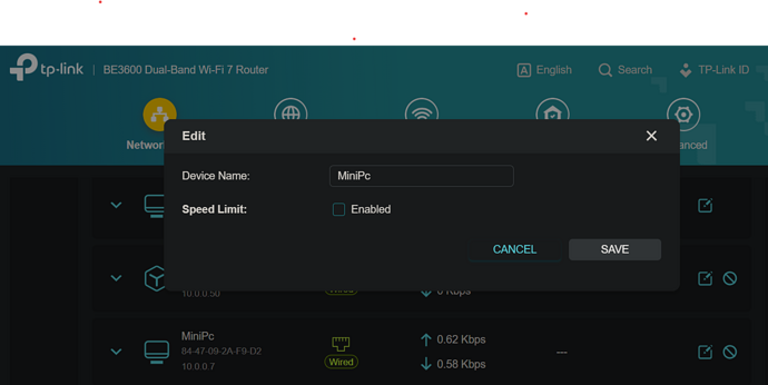

for some reason on my setup there's a docker to localhost connection that doesn't ^ always resolve the host names for me.
Do you use Tailscale? Have you established a domain name for your LAN (most decent routers support this) -- like localdomain or lan?
OliveTin has a DOMAIN variable, and you can set your LAN and Tailnet domain names there.
unless i'm missing something this is the closest i can get with a cheep router. I just saw I can change it, but it's been set to that the whole time, so unless case matters, the router should know the name. also, I am running a pi-hole.
With Pi-hole, that should be your DNS server in order for it to do anything. Go into your Pi-hole WebUI, and create local DNS records for whatever. E.G. shaggy-mancave could be assigned to 192.168.x.x. Then you could set CHANNELS_CLIENTS=shaggy-mancave, or CHANNELS_CLIENTS=shaggy-mancave shaggy-hometheater shaggy-snoozespot, to expand on the concept. :slight_smile:
