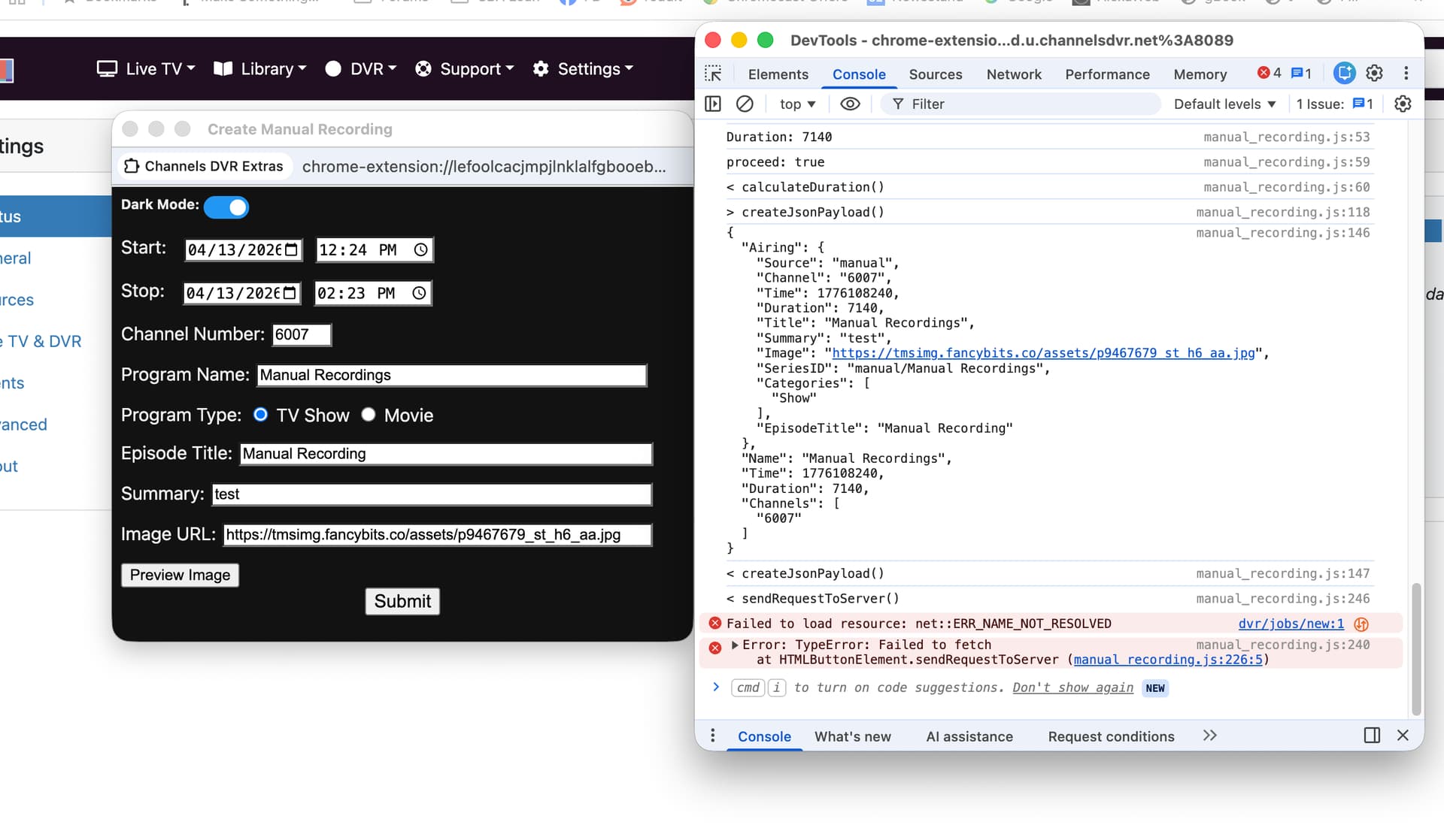

I'm not sure why this Chrome extension is giving me that "Failed to fetch" error when I try submitting a request. I'll try testing on another Mac or PC when I get a chance.

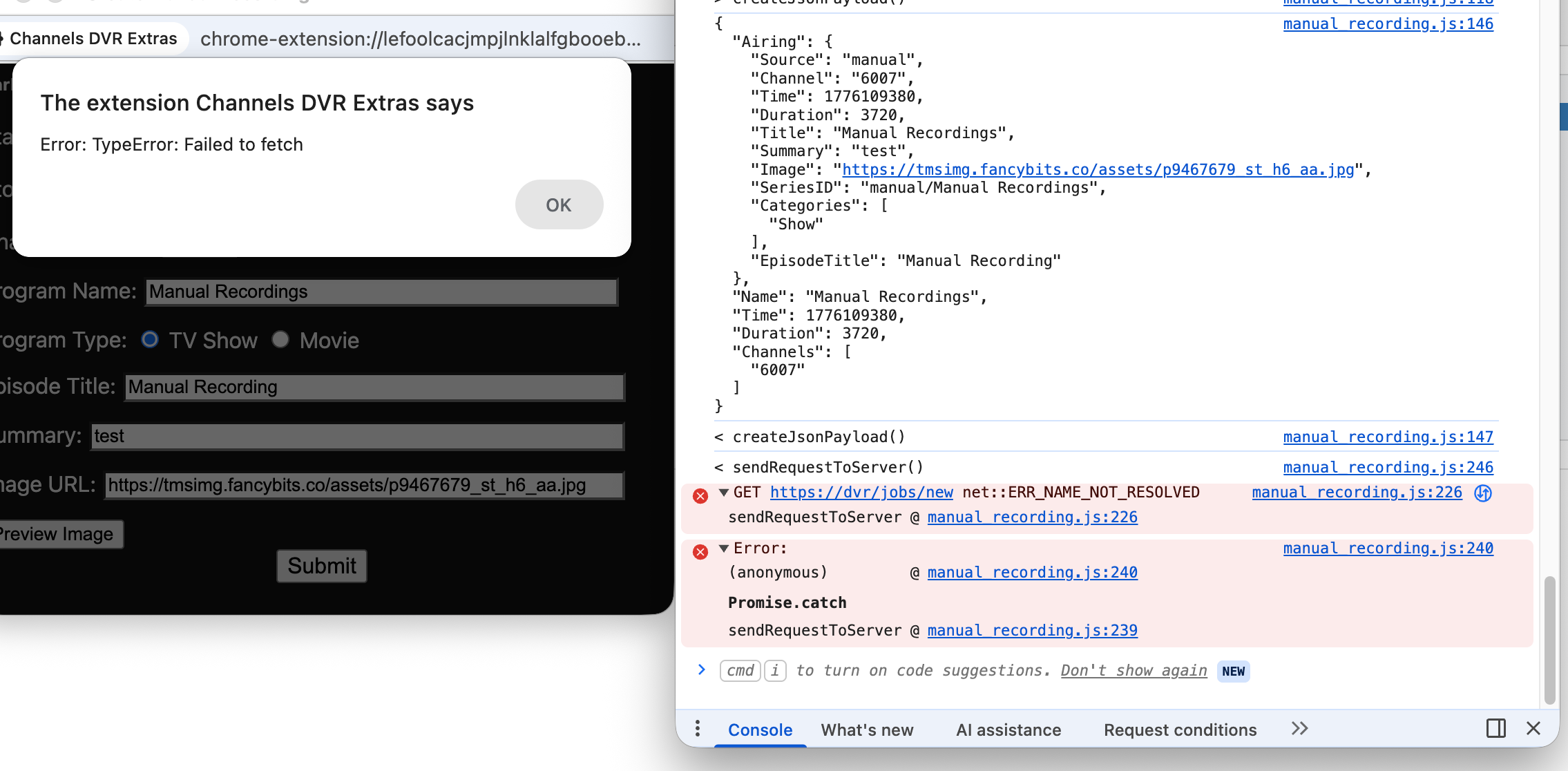

When you have a few minutes, could you please reproduce the error? Once you have the error pop-up, close it and then in the main Manual Recording window, please open the java console. It will have valuable information for me to look at.
This is what I see:
Can you expand the TypeError?
Thanks. At first glance, it looks like it didn't get an acknowledgement from the server.
I'll investigate.
Thank you for reporting this.
I just noticed now that the IP address and the port number of your server were missing in the request:
Also, it should be looking at http:// and not https:// so I don't know where this is coming from.
What was the URL of the main browser window when you opened the Manual Recording window?
Ah, that explains it. I was connecting to the CDVR web interface via my laptop using the remote URL bookmark (my.channelsdvr.net) instead of using its internal LAN IP (http://10.0.1.21:8089)
Once I switched to using the internal LAN IP instead, the Chrome extension worked again for creating a manual recording. Thanks!
