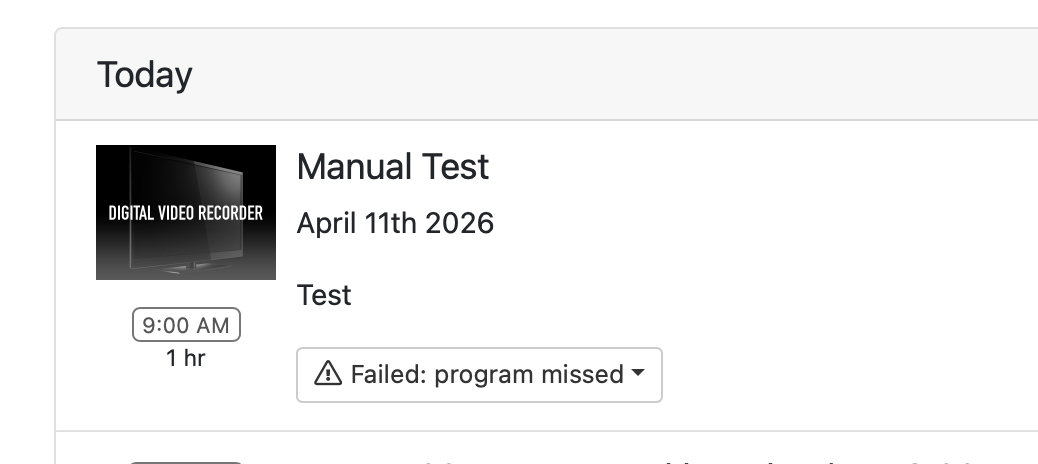

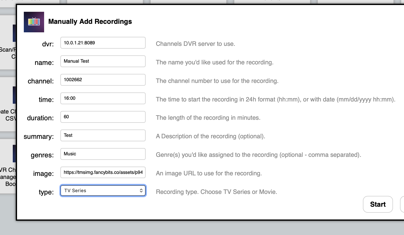

I tried the OliveTin function to "Manually Add a Recording" just now but the time assignment isn't translating properly. I want it to record at 4 PM so I enter 16:00 in the field as instructed but then when I check the DVR schedule I see that recording is scheduled instead for 9 AM, which is in the past. What am I doing wrong?
It looks like the latest version of Debian (13 aka Trixie), has dropped support for time zones in the Country/Timezone format, and is now insisting on the Continent/City form. So, stop your OliveTin-for-Channels stack and change:
TZ=US/Pacific
to:
TZ=America/Los_Angeles
and you should be good to go.
Thanks for reporting this.
