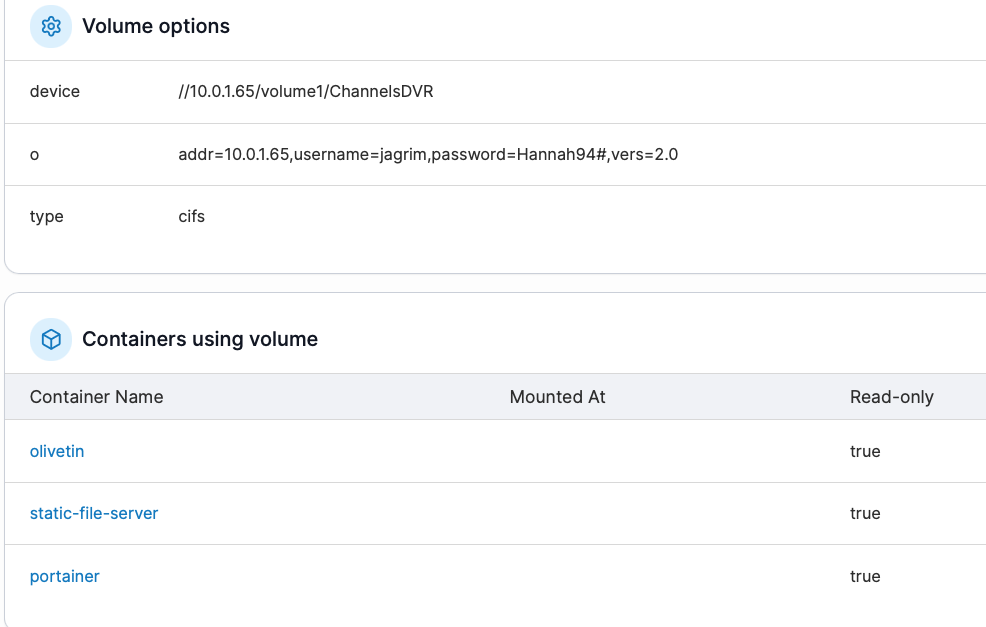

The Samba shares need to be setup as Docker Volumes. Look in the Portainer WebUI, and you'll see a section for Volumes. You need to create a Docker Volume for each of your Samba shares. This volume needs to point to a valid Samba (aka CIFS) share on your Synology, and will contain the username and password for that Samba share.
So this is the channels-dvr volume that I created. Does it look correct or what changes should I make. Once it’s correct, I’ll create the logs mount.
Workin to create a local foldeer now
Do you have a WIndows computer where you can test the Samba shares. The way you have it setup, //10.0.1.65 is the host, volume1 is the share, and ChannelsDVR is folder in that share. This could be correct, but it'd be handy if you could confirm using Windows File Explorer.
Should be Synology220/Volume1/ChannelsDVR
I just had to change the ip to the hostname
Using CIFS/SAMBA it would be \\host\SynoSharedFolderName
So \\10.0.1.65\ChannelsDVR
or \\Synology220\ChannelsDVR
You don't specify volume1 for a Synology share, all the shares are shared folders in volume1
