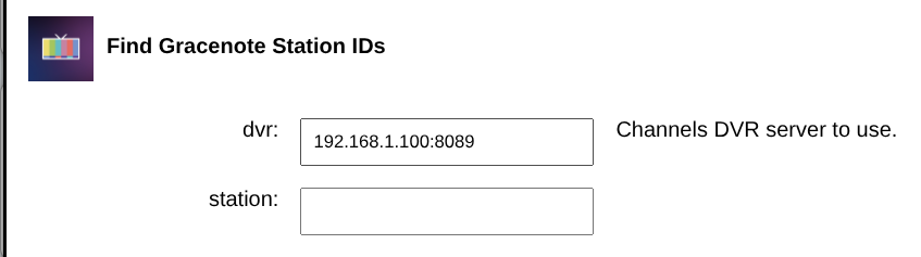

@bnhf , After reinstalling OliveTin, I notice that it seems to behave a little differently now.
In the past, when choosing one of the actions, the window which opened to make entries for some of the variables used to populate with the last used previous value.
For instance, dvr: 192.168.1.100:8089, as below:

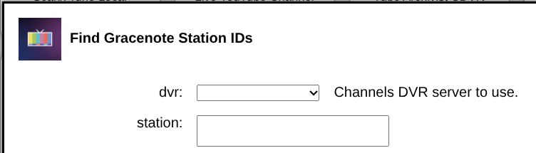

Now, it seems to only populate with blanks or default arguments,
For instance, dvr: none, as below:
To fill the variable entry box, I have to clear the "none" value and click or start typing. Then, previous values appear in a drop-down list.
Could you post the full Standard Output from the OliveTin Post-Install Healthcheck. The one from 9 days ago is only part of the output.

Your healthcheck looks good. Could this be something with the browser? Have you tried clearing cached images and files from your browsing history? Or maybe try another browser to see if it looks the same?
Just tried both suggestions. I cleared cached images and files on Chrome and the outcome is the same. Same with the Edge browser on a different computer.
Maybe I've gone batty and remembering incorrectly. I could swear that it used to at least keep the first entry (dvr: ) on some of these actions. It saved a lot of keystrokes when doing repetitive tasks like looking up Gracenote ID's.
If you have a single DVR specified it should be filled in for you. If you have multiple DVRs you should have a dropdown to choose between them.
Can you post the following from the env vars section of your OliveTin stack?:
CHANNELS_DVR_HOST=media-server8
CHANNELS_DVR_PORT=8089
CHANNELS_DVR2_HOST=utheater-pc
CHANNELS_DVR2_PORT=8089
Post any env vars containing CHANNELS_DVR...
This is all I have:
CHANNELS_DVR_HOST=192.168.1.100
What's your HOST_DIR value?:
Mine:
HOST_DIR=/data
I have this for the new installation:
HOST_DIR=/volume1/docker

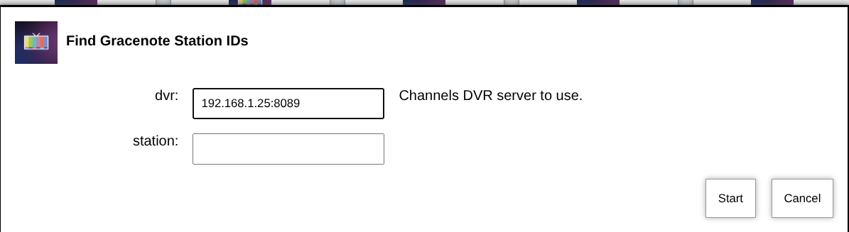

I found my original variables on an older installation on my backup server, running OliveTin-for-Channels 2025.03.05. The variables are pretty much the same as above and as I previously posted.
The differences I see are that it has "DOMAIN=tailxxxxx.ts.net" and "CHANNELS_DVR2_HOST=another-server" and does not have "TUBEARCHIVIST_SHARE=/volume1/ChannelsDVR" as an environment variable at all.
TAG=latest
HOST_PORT=1337
CHANNELS_DVR_HOST=192.168.1.25
and
DVR_SHARE=/volume1/ChannelsDVR
The dvr: drop-down does auto fill on that one:
I think this has something to do with your original setup having two servers defined (even though one was bogus), and now you only have one. Let me play around with this and see if I can duplicate what you're seeing...
EDIT: I probably should make sure you've tried stopping and restarting the OliveTin stack?
Excellent question! That's the first thing I tried. (Proving that I am able to learn from previous mistakes)
Now, this may sound crazy...But, I tried playing around with the ENV variables a bit.
I added two lines with the "dummy" values for a 2nd DVR as my other server had:
When I opened the Gracenote ID action, this time I got a blank for the dvr: entry box, rather than "none".
It had a tab for pulling a drop down menu, which included both the main server IP and "another-server" to select from"
I remarked that this was interesting, yet not what I really was hoping for. So, I deleted the two added lines and updated the stack again.
Here's what makes me nuts...this time...wait for it...
BOOM! The main dvr: box populated right away! :exploding_head:
