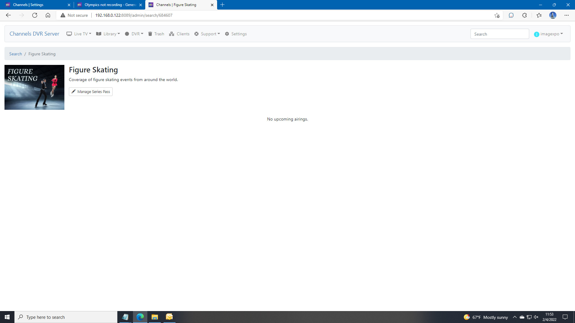

I have a recording set up for 'figure skating' that always worked before but although there are several Olympic events labeled figure skating scheduled this week the DVR does not show them to be recorded. Any idea what is wrong?

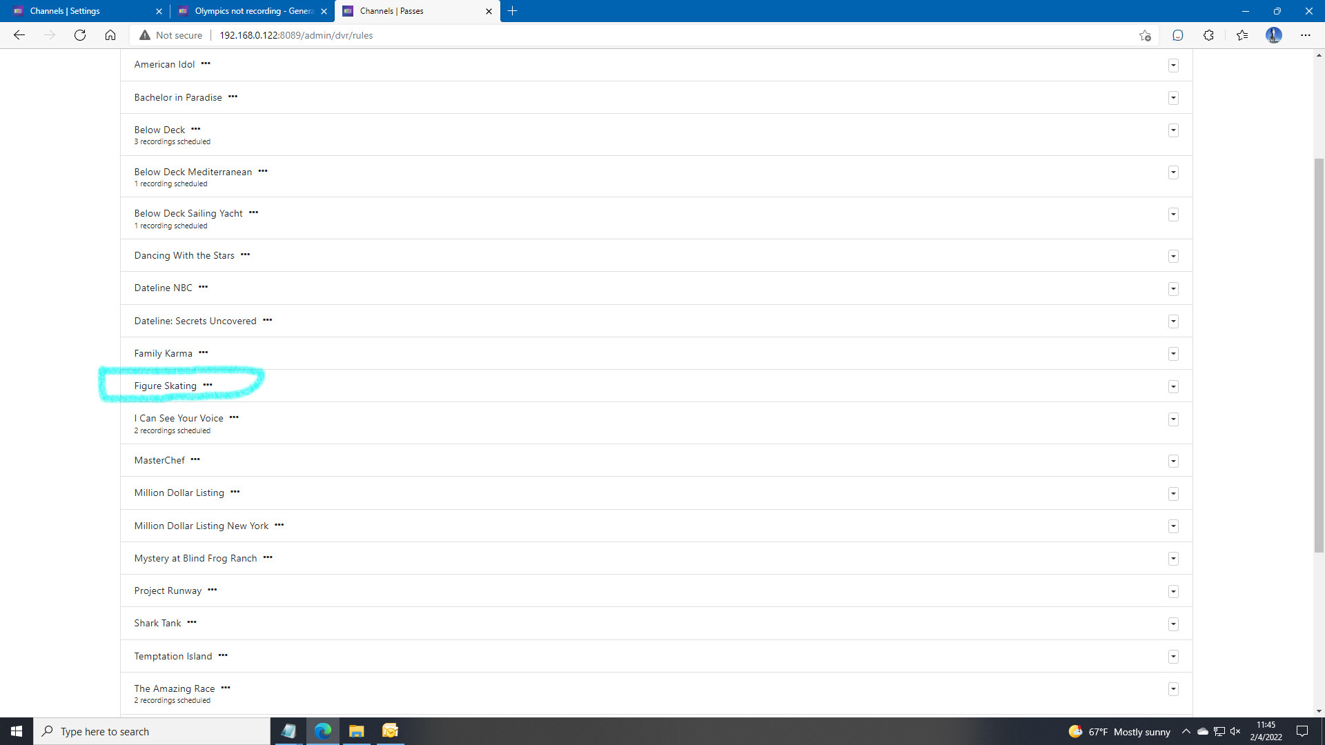

If I look in settings the search term figure skating is there and the guide shows figure skating on the schedule multiple times but nothing records.
Can you screenshot your pass settings
Please click the ... so we can actually see the rules you have set

Try creating an advanced pass with the rule: EventTitle CONTAINS Figure Skating
will do - even though several upcoming events ony have Figure Skating in the title.
That did it - thanks for the tip. I learned something
The original pass probably had the rule "SeriesID == 684607". The SeriesID for the Olympics is 21187664, so not a match. You can open your old pass in Advanced Mode to find out. (That's what @tmm1 was trying to get you to screenshot.)
An alternative rule, that's probably better, is "Genres CONTAINS Figure skating".
Note that the comparison is case-sensitive so "Figure skating" works but "Figure Skating" won't find anything.
