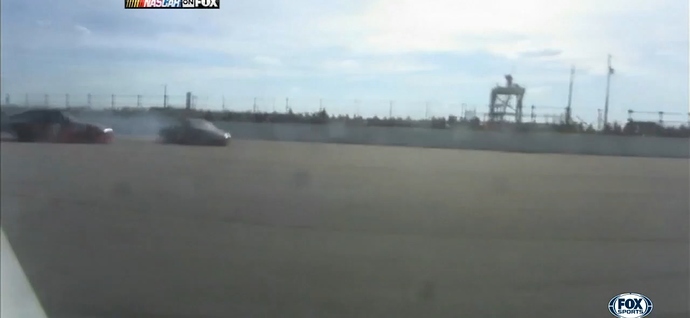

Just recently when using ChannelsDVR app on my OnePlus 7 Pro, the picture is stretched out and it makes everything zoomed in. Is there anyway to get rid of this. Perhaps this is happening because of the dumb aspect ratio phones are being released nowadays.

Because the aspect ratio on your phone is larger than 16:9 and it is stretching it to fill the screen. It is a setting on your phone to fill the screen. This is not a Channels problem.

I'm not sure why this is happening now. It's not the biggest deal in the world I suppose. At times the video plays normally and others the picture is stretched out. My LG G8 doesn't have this problem and it's aspect ratio is the same as my OnePlus 7 Pro. This makes me believe it's a OnePlus issue
