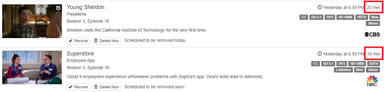

I have deleted Young Sheldon, but the duration it showed was 24 minutes. I thought that might have been in error so I watched the show and it did in fact only recorded 24 minutes.
I found the files in question and here's the recording lengths. The logs above show Young Sheldon recorded for 33 minutes but the file only shows 25 and that's the way it aired. Superstore shows 19 minutes.
Locast streams have been known to have problems in the past. The error is coming from their end, and not Channels. (I personally have had this problem, too. The problem is with small sections of the stream not being sent, and those small sections throughout the recording accumulate.)
OK, thanks for the info!
